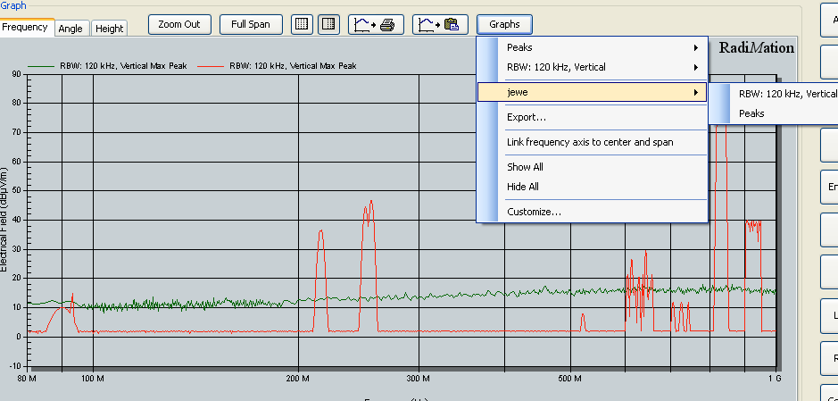

I tried to overlap the results of two different emission tests with eachother (in version 2013.1.7). Using the method:
To overlap two graphs, open both the test results. In one of the two test results press the graphs button. you will see that the other test is available for selection. You can add any line from the other test result into the current graph.
In my situation it was working correctly (see the screenshot below). The only potential problem I observed, that it could be a problem if the description of both emission tests is the same. Is the description for both tests the same in your situation?
Overlapping graphs from two different emission tests
