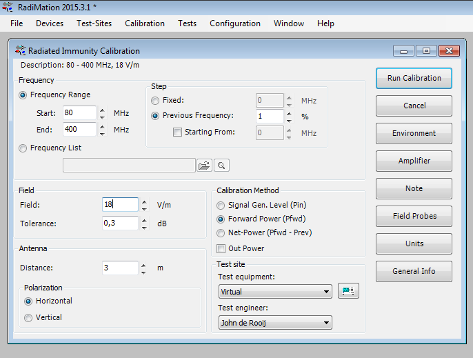

4. Configure the radiated immunity calibration with the correct parameters. Ensure that:
  • Forward power calibration method is selected
  • A 1.8 times higher electrical field strength should be used during the calibration. So 18 V/m for a 10 V/m substitution test.

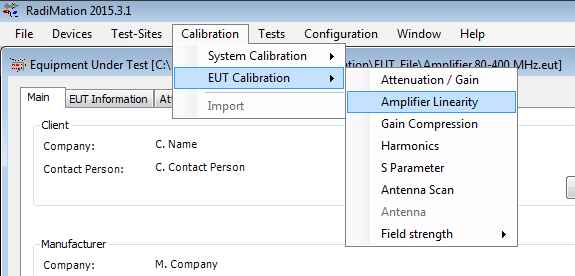

8. Now start the amplifier linearity test by selecting from the main menu: Calibration > EUT Calibration > Amplifier Linearity

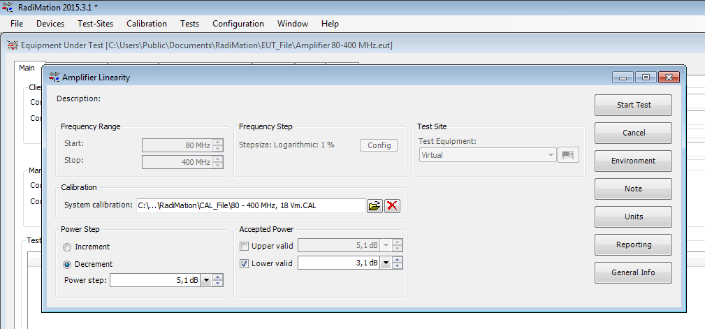

11. The following parameters can be configured in this test:
  • The 'Increment' or 'Decrement' of the 'Power Step' specifies the direction in which the power should be changed. For the EN 61000-4-3 this is normally 'Decrement'. For the EN 61000-4-6 this is normally 'Increment'
  • The 'Power Step' is the dB value in which the signal power should be changed. This is normally 5.1 dB.
  • The 'Lower valid' of the 'Accepted power' specifies the minimum change of the forward power to be valid for the linearity check. This option cannot be turned off, and should always be specified. This value is normally 3.1 dB.
  • The 'Upper valid' of the 'Accepted power' specifies the maximum change of the forward power to be valid for the linearity check. This option can be enabled or disabled. An often used value is 7.1 dB, but the latest versions of the EN 61000-4-3 do not restrict the maximum forward power change.

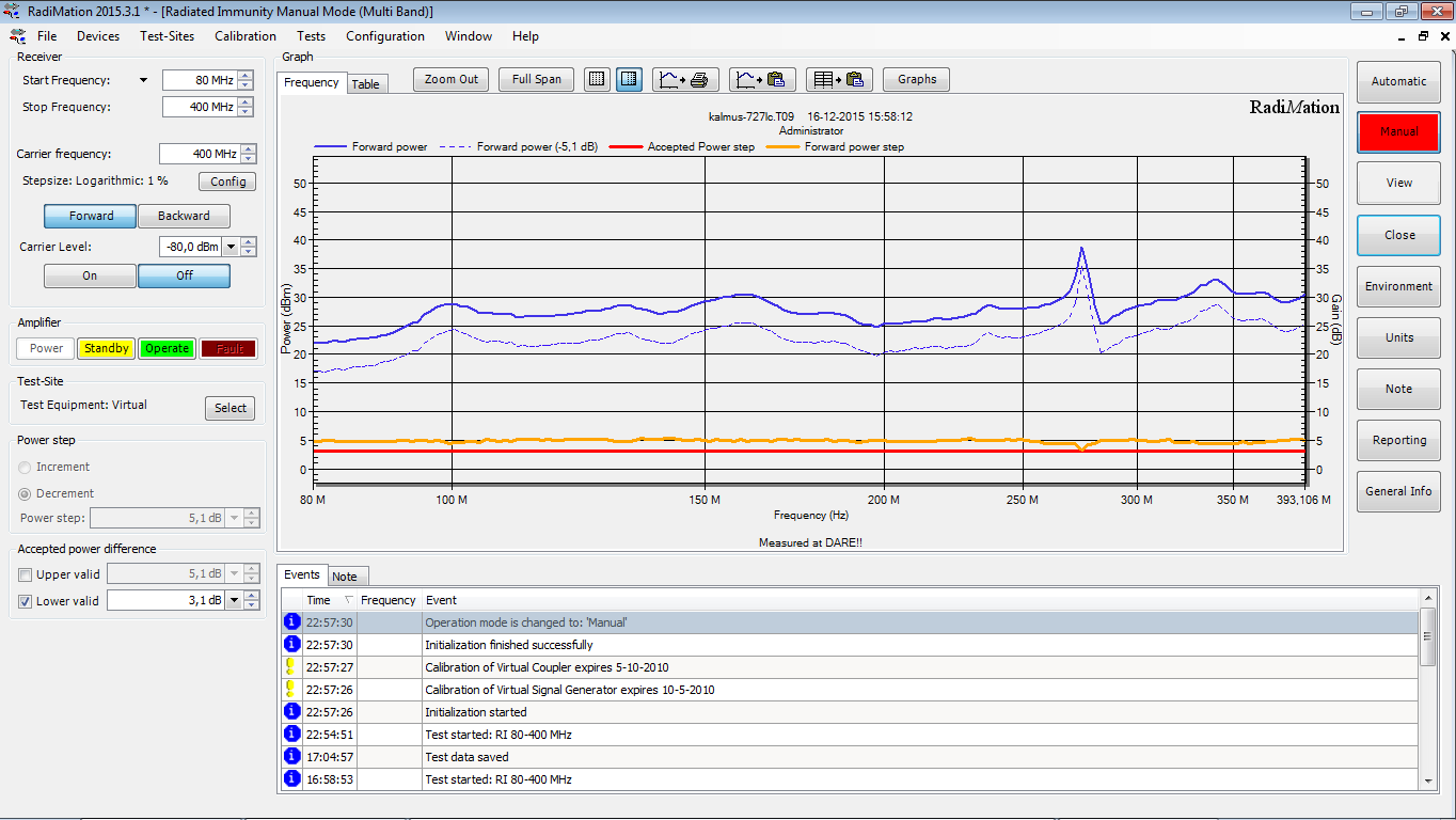

14. During and at the end of the test, the different measurements are shown in the graph.
Example results of the Amplifier Linearity test
15. The 'Amplifier Linearity' is shown as the 'Forward power step' (as the orange line in the screenshot above), and the configured limit values are shown as the 'Accepted Power step' (as the red line in the screenshot above). The limit line values can also be modified with the 'Accepted power difference' settings on the bottom left side of the result window.
16. If the 'Forward power step' line is within the 'Accepted power step' values, the amplifier fulfills the 'Amplifier linearity' requirements.
