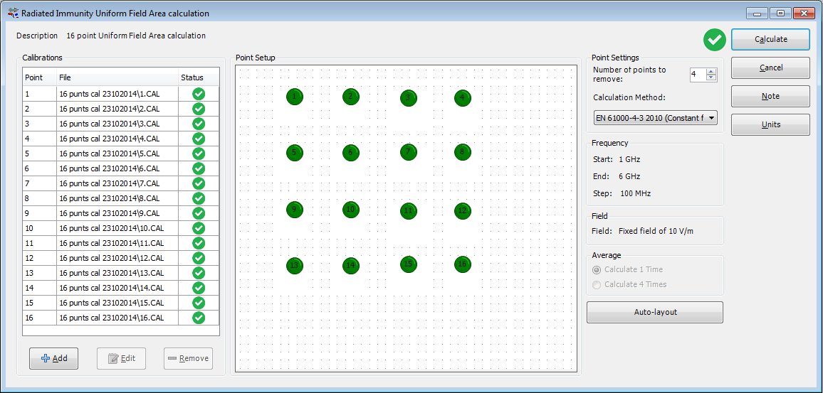

The configuration of this calculation allows:
  • Adding any number of points (maybe more than 16)
  • Customizable layout of the points
  • Selection of calculation method to use
Configuration of the 16 point UFA Calculation

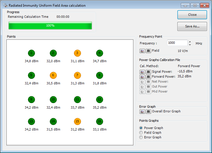

After the 16 point UFA calculation is performed, the results are shown, including a points grid including different colours of the points.
Result of the 16 point UFA Calculation

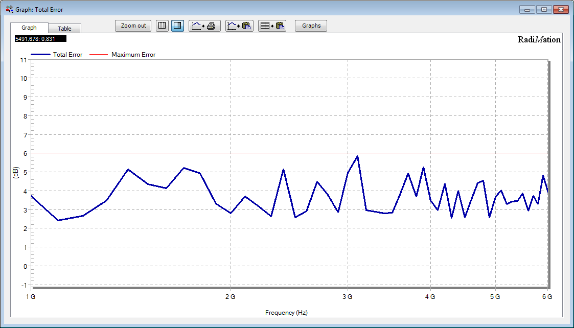

And from this result window more advanced graphs can be shown to investigate the exact behaviour of the Uniform Field Area
Graph of the Total Error of the 16 point UFA Calculation
