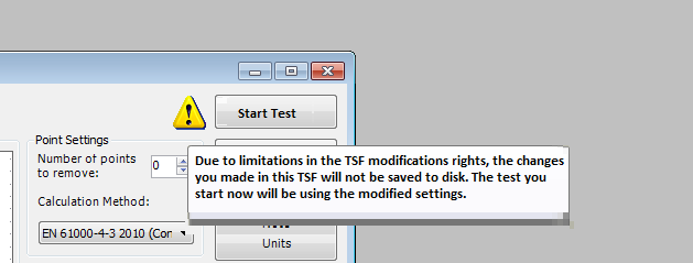

It can for example be something like this: (Not implemented yet!!, graphically adjusted/drawn):
Example of tooltip of warning
Is this what you want, and does it fullfil your request?

Dear John,
yes of couse, only for Radimation right not for windows or other file rights.
I would like it your solution with the (!) warning.

Hello Lueder,
Ok. Thanks for the feedback. I understand that you do like the proposal.
This is indeed an acceptable solution for your request.
I registered this discussion in our database as: #6799: Don't ask to save testfile in case the user is no administrator
As this is a request for a new functionality, we currently do not know when this wish will be implemented in RadiMation.
