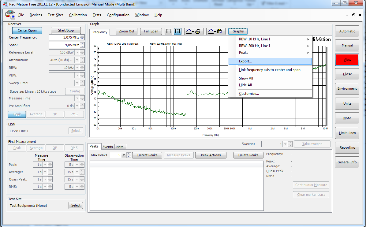

  1. Open the test results of the measurement
  2. Click on the ‘Graphs’ button above the graph
  3. Select the ‘Export…’ option from the popup menu
    Select the 'Export...' option from the 'Graphs' menu

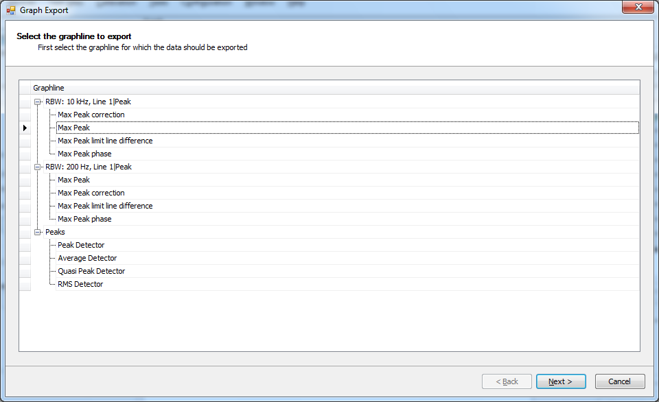

  4. Select the graphline of which you want to export the data, and click on ‘Next’
    Select the graphline of which the data should be exported

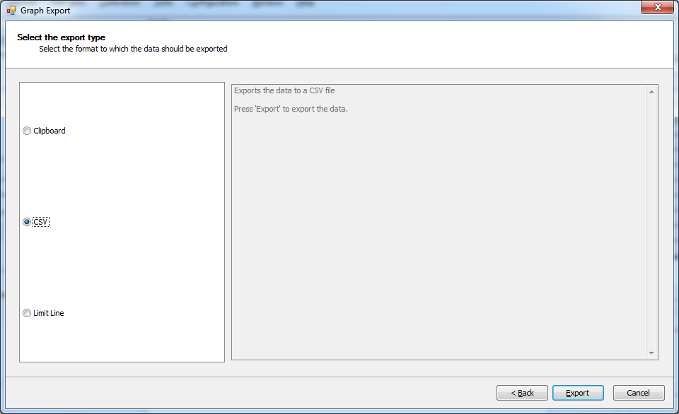

  5. Select the type where you want to export the data to.
    • Clipboard: copies the data to clipboard, after which it can be pasted in for example Microsoft Excel
    • CSV: exports the data to a CSV file, which can be opened by other software packages.
    • Limit Line: exports the data to a Limit Line File (LLF), which can be used as a reference line in other measurments
    Select the type to which the data should be exported
  6. Press on 'Export'. Depending on the selected export type, it is possible that a 'Save File' dialog is shown, which allows you to specify the location and name of the file
