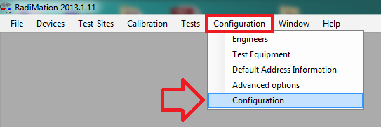

Open the 'Device drivers' window by clicking in the menu -> 'Configuration' -> 'Configuration' (figure 1.1) and then on the correct tab or open it directly by the menu -> 'Devices' ->
'Configure...' (figure 1.2).
1.1 menu - configuration - configuration.png (21.65 KiB) Viewed 25407 times
1.2 menu - devices - configure.png (29.37 KiB) Viewed 25407 times

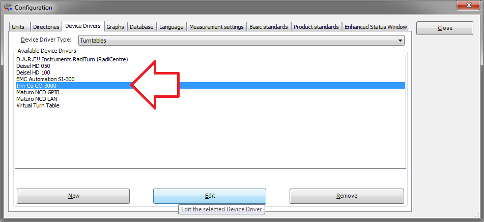

Then click on the dropdown menu and select 'Turntables' (figure 2).
2. devicedrivers_turntables.png (32.99 KiB) Viewed 25407 times

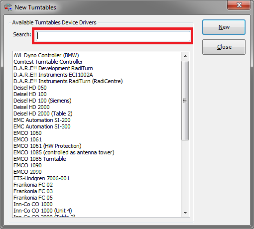

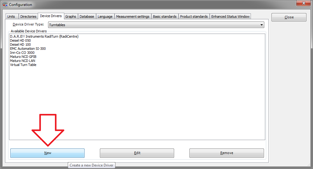

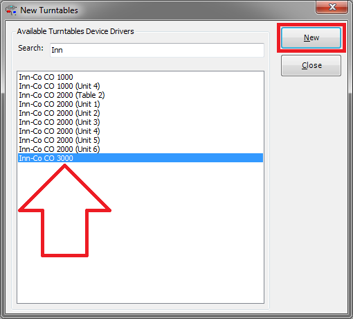

Click on the 'New' button to create a new turntable device (figure 3.1) and the device driver database will be searched when you start typing (figure 3.2).
3.1 devicedrivers_turntables - new.png (28.49 KiB) Viewed 25407 times
3.2 devicedrivers_turntables - search.png (24.68 KiB) Viewed 25407 times
When the corresponding device is found, select this device driver from the list and click 'New' (figure 3.3).
3.3 devicedrivers_turntables - select and create new.png (17.55 KiB) Viewed 25407 times

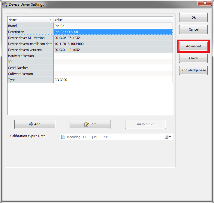

Now the device driver configuration window (figure 5.1) is opened.
5.1 devicedrivers_turntables - advanced configuration.png (31.52 KiB) Viewed 25407 times
Click the 'Advanced' button and from the newly opened screen (figure 5.2) the 'GPIB' button.
5.2 devicedrivers_turntables - advanced configuration open GPIB.png (13.46 KiB) Viewed 25407 times

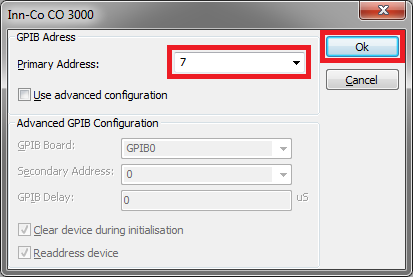

Configure your GBIB address in this window (figure 5.3). Confirm and close all underlying screen by clicking on the 'Ok' buttons.
5.3 devicedrivers_turntables - advanced configuration GPIB configuration.png
5.3 devicedrivers_turntables - advanced configuration GPIB configuration.png (17.99 KiB) Viewed 25407 times

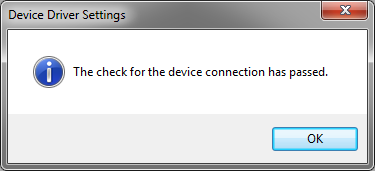

After this configuration it is recommended to perform a quick 'Check' (use the button from figure 5.1) to see if these communication settings are correct and the device is recognized (figure 5.5).
5.5 devicedrivers_ settings check passed.png (13.61 KiB) Viewed 25402 times

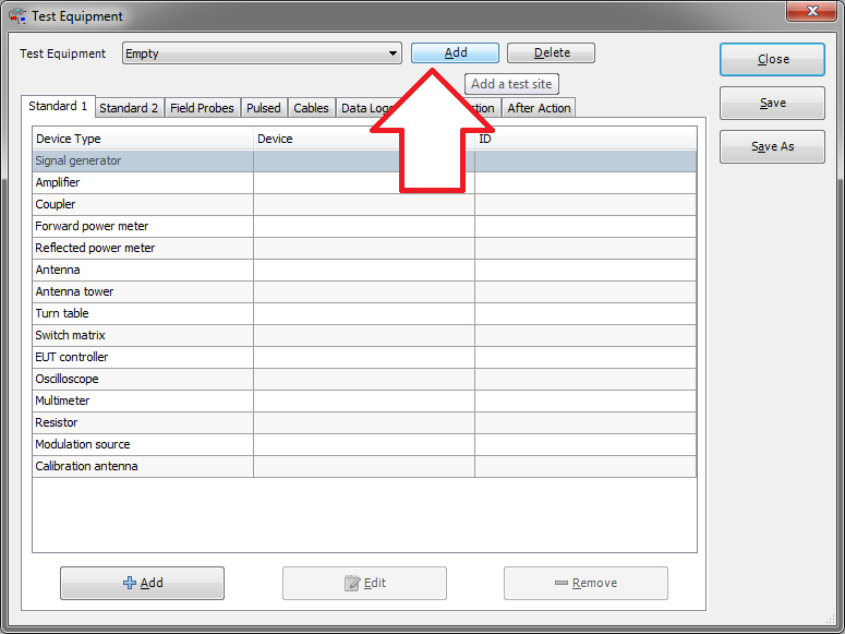

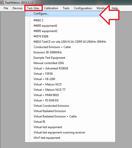

Click in the menu -> 'Test-Sites' -> 'Configure...' (figure 6) and click the small 'Add' button in the new window to create a new Test Equipment (figure 7.1).
6 menu - test-sites- configure.png (30.56 KiB) Viewed 25407 times
7.1 test equipment - add new test equipment.png (33.41 KiB) Viewed 25407 times

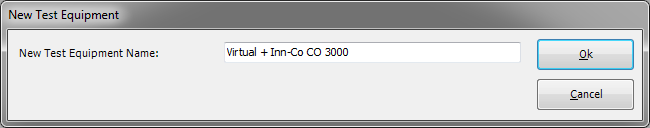

Give a new name to your Test Equipment e.g. 'Virtual + Inn-Co CO 3000'. Click on the 'Ok' button to confirm (figure 7.2).
7.2 test equipment - name of new test equipment.png (10.08 KiB) Viewed 25407 times

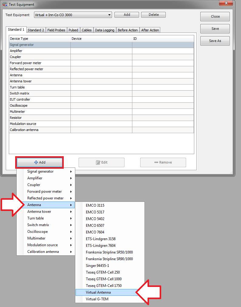

Start adding devices to this Test Equipment by clicking on the large 'Add' Button and selecting the correct device driver type and name (figure 7.3).
7.3 test equipment - add devices to test equipment.png (52.2 KiB) Viewed 25407 times

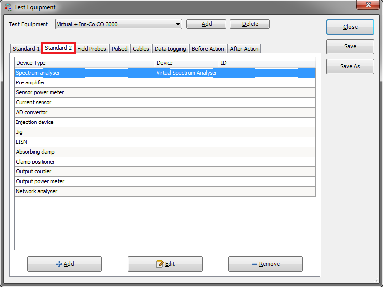

Repeat this process for all other devices which are necessary to add. The devices are categorized into several tabs. So for instance if you want to add a Spectrum analysers, first open the 'Standard 2' tab (figure 7.4).
7.4 test equipment - add devices (tab2) to test equipment.png (31.97 KiB) Viewed 25407 times

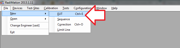

Create a new EUT file by the menu -> 'New' -> 'EUT' (figura 8.1) or simple by the shortkey 'CTRL + E'.
8.1 menu - New - EUT.png (22.21 KiB) Viewed 25407 times

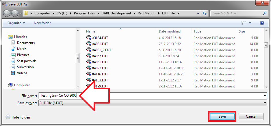

Enter a file name e.g. 'Testing Inn-Co CO 3000' and click 'Save' (figure 8.2).
8.2 menu - New - EUT save as.png (67.64 KiB) Viewed 25407 times

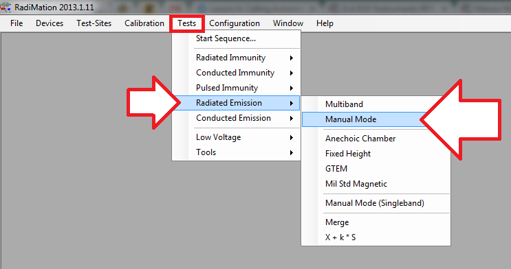

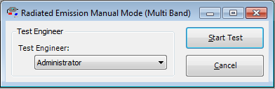

Leave this (newly opened) EUT screen open to be able to perform any test. Select from the menu -> 'Tests' -> 'Radiated Emission' -> 'Manual Mode' (figure 8.3).
8.3 menu - Tests - RE - Manual Mode.png (34.31 KiB) Viewed 25407 times
Select the Test Engineer you want to use for this test and confirm with 'Start Test' (figure 8.4): the test window will be opened.
8.4 Tests - RE - Manual Mode - select Test Engineer.png (8.92 KiB) Viewed 25407 times

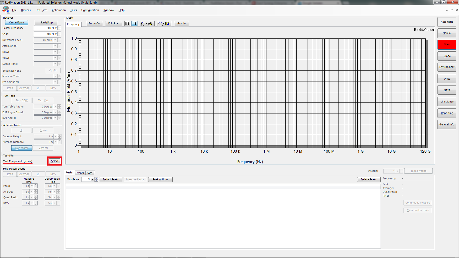

Finally it is yet needed to select a Test Equipment, use the 'Select' button (figure 8.5).
8.5 Tests - RE - Manual Mode - select Test Equipment.png (165.34 KiB) Viewed 25407 times

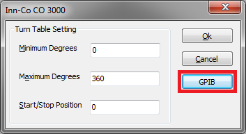

Now, in this manual test it is possible to remote control your turntable (figure 8.6).
8.6 Tests - RE - Manual Mode - Turn Table settings.png (4.52 KiB) Viewed 25407 times
