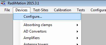

To configure the Switch Matrix, go to Devices > Configure..

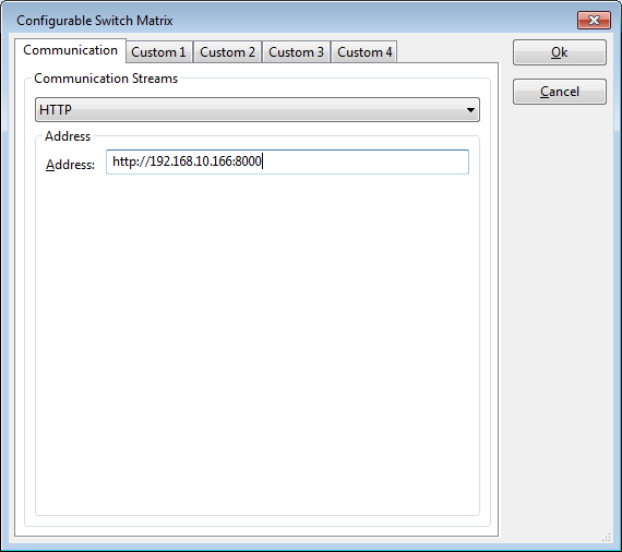

In the next window, select the 'HTTP' option under 'Communication Stream'. Configure the Address with the correct ip, domain and port of the corresponding device (e.g. http://192.168.10.166:8000).

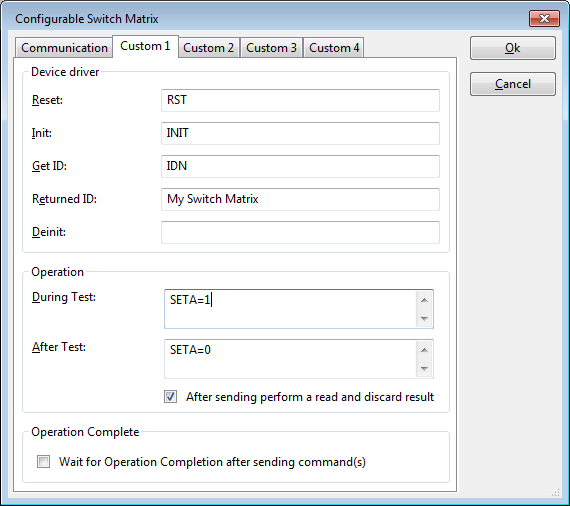

Go to the 'Custom 1' tab on the same window. Here you can configure commands of the corresponding device. The configured commands are send to the device using HTTP requests. For example, the command SETA=1 is sent as request http://192.168.10.166:8000/SETA=1.
Please refer to the documentation of the corresponding device for more information about the available commands.
