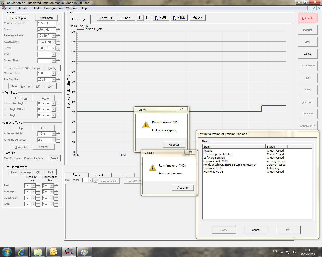

Re: Frankonia FC05 driver
Hello again John,
bad news, new drivers (20120425) don't detect (in the driver check) the FC05 neither with null delay nor with 100ms delay. I noticed that advanced settings for the driver are not remembered between configurations.
After that I reinstalled the first version (20120411) and FC05 is detected again and behave as commented in previous messages.
As usual, i attach a NI Spy log of the new drivers check process.
Thanks,
Toni
Thanks,
Toni
- 20120425_FC05.zip
- NI trace capture of the driver check process
- (1.75 KiB) Downloaded 63671 times

although i had not write down explicitly before i came to the same conclusion as you: Frankonia controller implementation is somewhat wrecked.
That said, i check the latest drivers and now FC05 is correctly detected. But now, when the measure is started a runtime error (28) appears. After a while another one (400) and when you push both buttons, Radimation shuts down inmediately.
As usual, i captured NI trace and a screen print. Hope they help.
Regards,
Toni
P.S. I asked Frankonia distributor for a firmware update, but i get the feeling that there's no such update
P.S.2 If there is some way to test SRQ line response (even with manual commands or some kind of script -Matlab-) please let me know.
Regards,
Toni

- Screen capture
- Run time error.png (246.7 KiB) Viewed 2157348 times

Hello Toni,
Thanks for sending me the screenshot and the ni-spy capture.
At least it is now clear the Frankonia FC05 is behaving differently then we expected. At this moment there is no need for you to investigate it further. The NI-SPY file from your previous post (20120425_FC05.zip) , does contain enough information for me to contact Frankonia to discuss this behaviour with them.
I'm sorry that we are now observing some other unexpected errors. I have some idea's how I can verify this tomorrow, but I have to do it with some equipment that I'm having in the office. I will keep you updated.

Hello Toni,
I got a confirmation from Frankonia, that they do not have an update for their firmware of the FC05 yet.
I modified our device driver for the FC05 to provide a workaround for the FC05 problem.
Also the run-time errors '28' and '440' should be fixed with these updated device drivers.
Could you test the updated device drivers?
Thanks in advance!
Thanks in advance!
