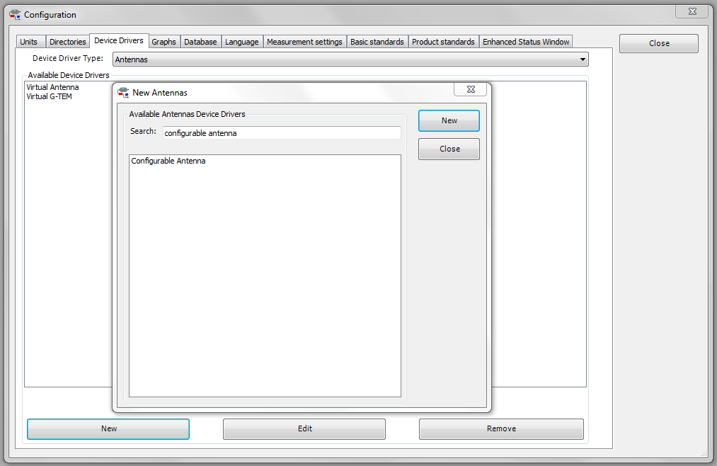

Click in the menu Configuration --> Configuration. Then open the tab Device Drivers and select your device type. In this particular example select 'Antennas' from the pull down menu. Now click the 'New' button and search for 'configurable antenna', as shown in the figure 1 below.
1new antennas search for.PNG (56.2 KiB) Viewed 7506 times
1 Device Drivers

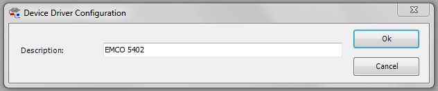

Select the 'Configurable Antenna' and hit the 'New' button. Now you can enter the description (type) of your device driver (figure 2) and click 'Ok'.
2 Description

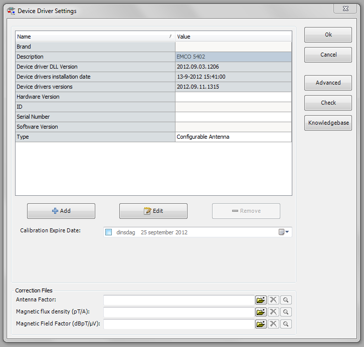

The configurable device driver is now added. Select it and click 'Edit' to configure the settings (figure 3).
3 Settings

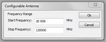

Here you may enter the 'Brand' name if you like. On the right click the 'Advanced' button. It's important to enter the correct Start and Stop frequency and then click 'Ok' (figure 4).
4 Start and Stop Frequency
Now you are ready!
