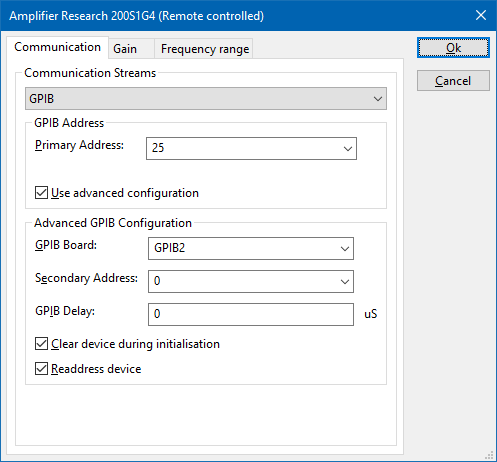

In RadiMation the standard device driver of the GPIB instrument can be used. Do take care that the correct GPIB-board identifier is selected. This is available as an 'Advanced option' in the GPIB configuration dialog.
In the following screenshot the Amplifier is configured to use GPIB address 25, which is connected to the GPIB-ENET/1000, which is configured in the NI-MAX software as being GPIB2.
