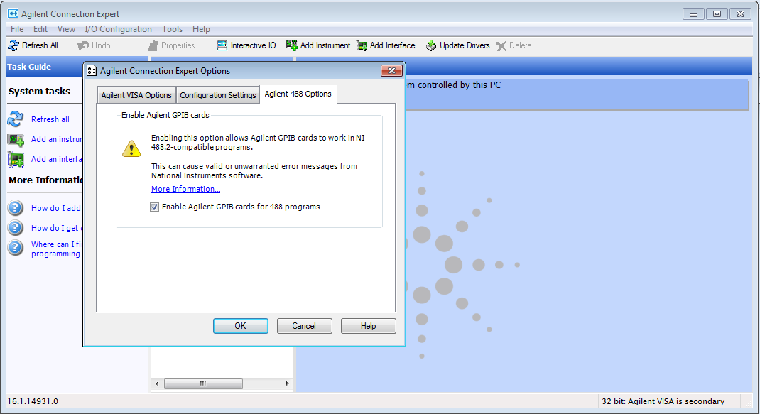

Agilent provides the tools to emulate their GPIB interfaces as being a National Instruments GPIB Interface. By configuring the Agilent GPIB interfaces in this way, RadiMation can correctly use the Agilent GPIB interfaces.
Please see: In most situations it is sufficient to open the 'Agilent Connection Expert', then click Tools > Agilent 488..., then select the check box labeled Enable Agilent GPIB cards for 488 programs.
Enable the Agilent GPIB Interface for NI488

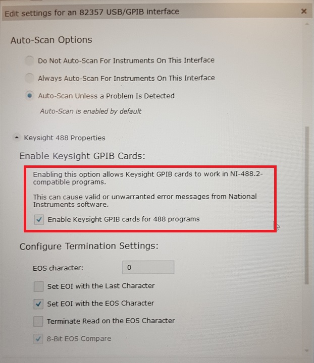

In the newer Keysight IO Libraries suite, the same setting can be found in the properties of the GPIB card in the IO Connection expert.
The dialog is different but still contains the same setting to enable the 488 compatibility mode.
IO Libraries suite 488 Compatible mode
Keysight GPIB 488 Compatible mode.jpg (113.95 KiB) Viewed 56232 times
