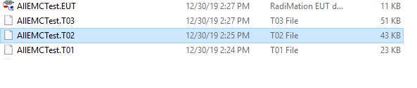

In RadiMation we use EUT files to store the information and tests that performed on an EUT. EUT stands for Equipment Under Test. You can do all different kind of tests on an equipment under test and save it in the so called EUT file. All the tests are saved as T** files (mostly referred to as test data files, as these contain the actual data from the tests). The '**' is a sequential number as part the extension of the file. Typically an EUT file and its associated test data files will look like this:
