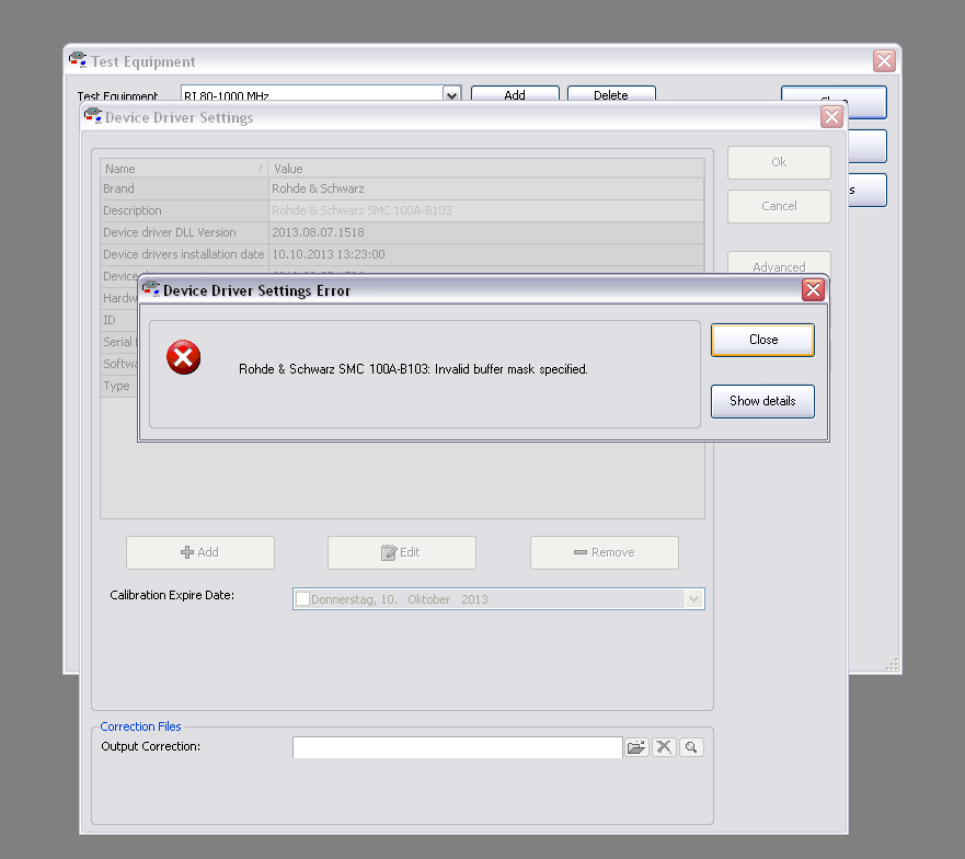

since I have installed the new radimation SW, I have a communication error between Radimation and signal generator (Rohde & Schwarz SMC 100A).
Attached you can find a screenshot.
With the last SW update, I had allready a communication error between radimation and signal generator. The solution, to solve the problem was to copy the radrssg.dll file from the old version to the new version. But now this measure did not work.
Any ideas?

An update on the new device drivers helped to solve the problem.
