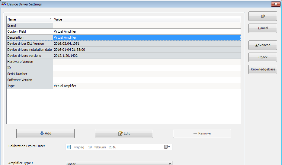

Dear Radimation support,
Is there any Keyword to get the 'Device drivers versions' in the RG? I have seen this topic viewtopic.php?f=15&t=116 and the links it references, but I cannot find a Keyword for the RG. Also in http://wiki.dare.nl/wiki/index.php/Chapter_13 I could not find it, only the specific driver versions for each instrument.
Nicolás.-

Hello Nicolás,
There are indeed report generator keywords to get the 'Device Drivers versions' information into the report.
Assume that the following information is available in a device driver configuration:
Device driver settings, including a 'Custom Field'.
Every entry that is included in the additional device driver information can be retrieved. The code to retrieve it is: ||<TEST>|<DEVICE_USAGE> EXTRA INFORMATION <INFORMATION_FIELD>||

It is even possible to get any field that is manually added. In the above screenshot also the 'Custom Field' is available. The corresponding report generator keyword is:
AMPLIFIER EXTRA INFORMATION CUSTOM FIELD: ||A_TEST|AMPLIFIER EXTRA INFORMATION CUSTOM FIELD||
I hope that this clarifies what is possible, and this answers your question.
