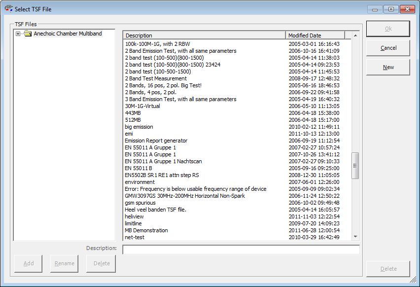

How do you rename a TSF file? When I pull the entry up under the test tab the rename button is greyed out
Re: Howto rename a TSF file?
The 'Rename' button on the TSF File Selection window is used to Rename folder names in the folder-tree on the left side of the TSF File selection window. (also the 'Add' and 'Delete' buttons are used as operations on the folder-tree)
To rename a TSF it is best to open the TSF, and then select from the 'File' menu: 'Save TSF As...'.
