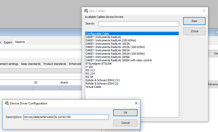

When you need to correct for devices that do not have a device driver or that do not have the capability to add a correction file you can add these as a cable in your test-site at the place where they are inserted in the signal path. We have called it cable but you can use this to correct for anything you insert in your path that you need to correct for. First let's define a cable. To make a cable that you can add to your test-site later on go to "Configuration"/"Configuration" in the upper menu.
Go to "Cables" and make a new cable. Select "Configurable Cable"
Give the cable a name that has meaning to what it is for. This is helpful for later troubleshooting and helps to visualize your path.

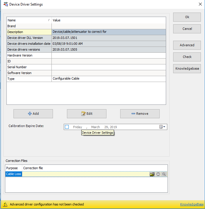

After creating the cable you need to attach a correction file to it. A correction file can be made by clicking the menu item "File/New/Correction" This will open a screen where you can edit your correction file and save it. When the correction file is made, add it by going to the settings of the specific cable and select a correction file via the selection box below.
Now that you have made a cable and added a correction file to it you can add this to your test-site to correct for transfer loss in your cables/attenuators etc.
