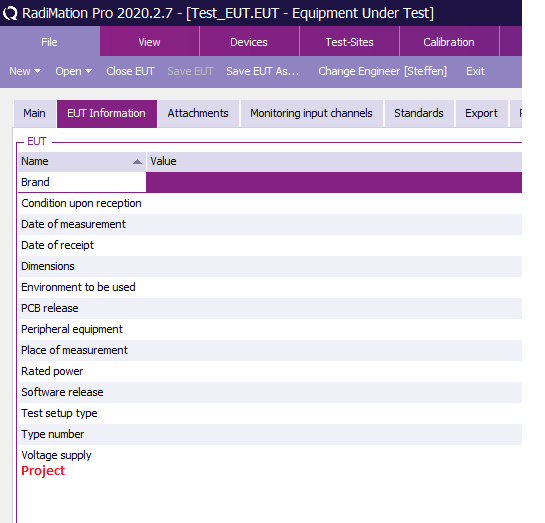

Hello all,
in a EUT window, it is possible to change the EUT information (Brand, Date of receipt,...).
I have added some rows like "project" for example.
Is it possible to save that EUT information for further EUTs? Means if I create a new EUT, the rows are again the default one, not the new one (e.g. Project) which I add in another EUT.
thanks and best regards
Steffen

Dear Steffen,
Yes this is possible,
See https://wiki.radimation.com/wiki/index. ... tion_items
Open the confdvdr folder in explorer. In that folder you will find a file eutinfo.ini
Add an extra option to the line with: EUTInformationItems

Perfect, thanks a lot for the quick reply!
