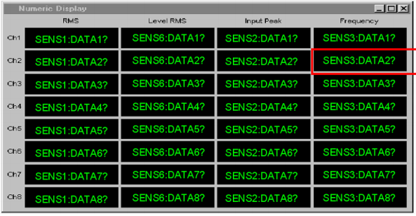

5) Configure the numeric display to show the desired value (Chapter 5.52)
6) Determine the correct SCPI command to retrieve the value (Chapter 7.5.4). This probably will be: SENS1:DATA1? but it can be another command, depending on the location of the desired measurement value as it is shown in the ‘Numeric display’ on the R&S UPV.
UPV Numeric display
UPV Numeric display
UPV Numeric display.png (64.21 KiB) Viewed 10755 times

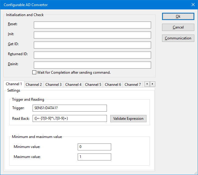

7) In RadiMation configure the ‘Configurable AD Convertor’ device driver.
8) In the ‘Advanced’ settings of the ‘Configurable AD Convertor’ device driver, specify the determined SCPI command as the ‘Trigger’ for ‘Channel 1’. The ‘Read Back’ should be an interpretation of the floating point number that is returned by the R&S UPV, and can be: ([+-]?[0-9]*\.?[0-9]+) Also be sure to specify a ‘0’ for the ‘Minimum Value’ and ‘1’ for the ‘Maximum Value’.

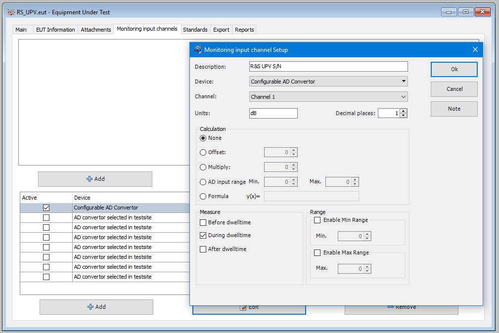

9) When the ‘Configurable AD Convertor’ device driver is created, that device driver can be selected in the EUT file as an ‘EUT Monitoring’ input.
UPV Monitoring input channel Setup
UPV Monitoring input channel Setup.png (42.46 KiB) Viewed 10755 times
The above settings and configuration, will achieve that when an Immunity test is started in RadiMation: at every tested frequency, the measurement value from the R&S UPV is retrieved as it is shown in the ‘Numeric Display’ of the R&S UPV.
