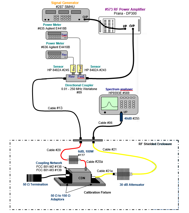

In our calibration setup for the Conducted immunity IEC 61000-4-6, we have multiple cables between the calibration jig and the analyzer that we are using to measure the injected voltage level.
At present I am having to combine all 5 transduced factors into one for the “Power Correction” when using the addressing the Sensor Power Meter (Spectrum Analyser).
In order to achieve the desired test severity level, do all the factors related to the monitoring (i.e. 40dB attenuator, cable 21, cable21a, cable701 and 30dB attenuator) need to be combined into one factor file and inserted in the “Power Correction” tab at the bottom of the Sensor power meter or is there another way of doing this?
As you can see from the image below we are using a Spectrum Analyser instead of a Sensor Power Meter, however there are more than one correction file we need to consider. They include the 40dB attenuator and Cable#06 outside the shielded enclosure and cables #21 &#21a along with a 30dB attenuator inside the shielded enclosure.
It would be ideal if RadiMation could simply add additional correction files within the Correction file tab, however it appears that I can only add one factor file, hence why I have combined all the factor files together into a single file name.
How would you best recommend I address this issue?
CI Calibration setup

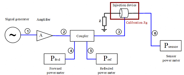

There is however a simpler and easier solution. Also see the picture of the testsite setup of a Conducted Immunity system calibration in our manual ( https://wiki.radimation.com/wiki/index. ... alibration )
The test equipment setup that is used by RadiMation for a Conducted Immunity System calibration

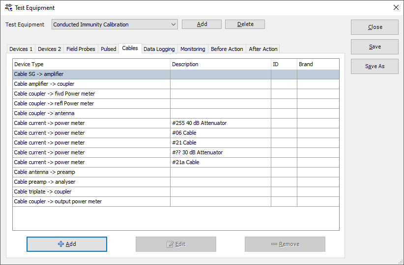

The cable between the calibration jig and the sensor powermeter that is numbered with '6' is the 'Cable current -> power meter' as it is available on the 'Cables' tab in the Test Equipment configuration. The configuration of the cables in the Test Equipment configuration allows that multiple correction files are added to the same 'Cable'. When multiple correction files are added for the same cable in a Test Equipment, RadiMation will combine the attenuation in the separate correction files to a combined attenuation which is then used by the test.
This is valid for all the cables that can be selected. Your complete setup as it is shown in your drawing can thus be configured in the Test Equipment as:
A test equipment configuration with multiple cables for the Current -> powermeter cable

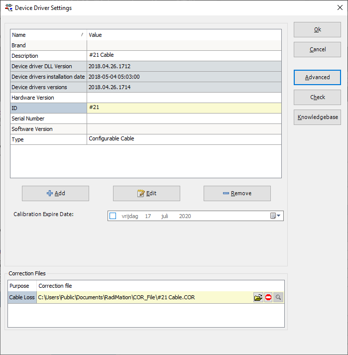

It may be necessary to create a 'Cable' device driver for each of the cables. In those device drivers the correction file of that cable can be selected for the 'Cable Loss' correction.
A device driver configuration of a cable
Once all the correct cables are selected in the Test Equipment it is not necessary anymore to have a combined correction file in the Powermeter device driver. Ensure that no correction file is selected in the 'Power Correction' of the powermeter device driver.
With this configuration it is possible to use a single correction file for each cable, and no manual calculation of the combined attenuation is needed. It also is much easier to switch cables in the future, as this can be achieved by removing one cable from the list of the selected cables in the Test Equpment, and adding another cable device driver.
