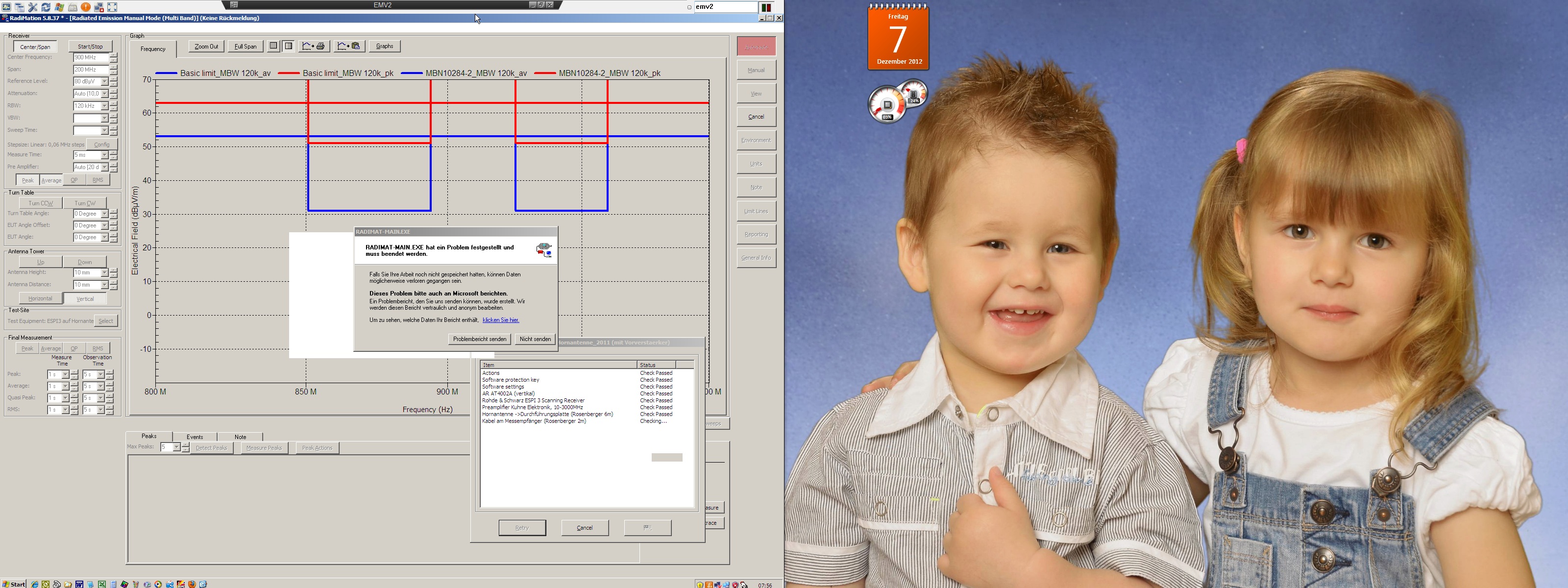

Hello John,
during the BCI measurement crashes the 5.8.37 version of Radimation. The same phenomenon appears during emission measurement too. It semms to happen during equipment check/initialising/deinitialising. See Attached files for more information. There are 2 files of the debbug logger from immunity, a screenshot from emission and the content of the system report to Microsoft
Thanx in advance for support

- Crash_EMI.pdf
- Content of the Microsoft report
- (70.11 KiB) Downloaded 960 times
- Screenshot before RadiMation coleses
- Crash_EMI.jpg (889.76 KiB) Viewed 10019 times

Hello Marius,
I reviewed the information you provided, but at this moment it is difficult to determine what is causing the crash.
Do you still observe this problem, if you perform this same test in version 2013.1.6?
Thanks in advance,
