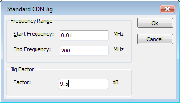

For a 150 Ohm system the correct jig transfer factor is 9.5 dB. Depending on the selected calibration jig device driver a calibration jig factor of 9.5 dB should be selected:
Calibration jig factor of 9.5 dB for a 150 Ohm system

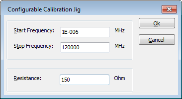

or a resistance of 150 Ohm should be specified for the 150 Ohm system:
Calibration jig resistance of 150 Ohm for a 150 Ohm system

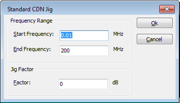

For a 50 Ohm system, (where no 100 Ohm resistors are included in the calibration jig) the calibration jig factor should be 0 dB:
Calibration jig factor of 0 dB for a 50 Ohm system

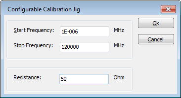

or a resistance of 50 Ohm should be specified:
Calibration jig resistance of 50 Ohm for a 50 Ohm system
