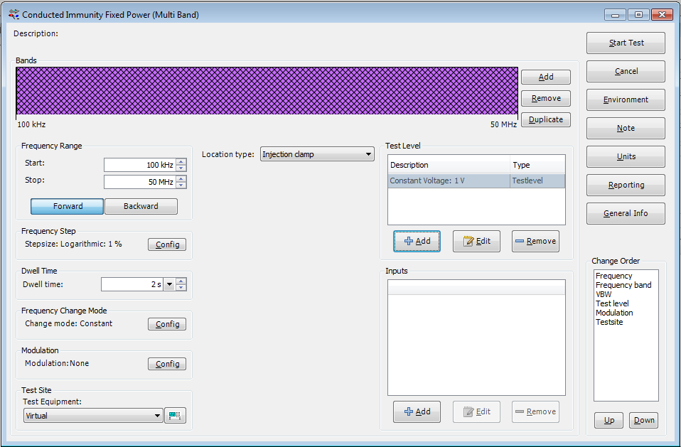

A Conducted Immunity fixed Voltage test can be configured using the following configuration:
CI Fixed Voltage test configuration

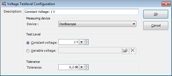

The 'Constant Voltage' testlevel configuration can be configured lik:
Constant Voltage Testlevel 1V
The 'Measuring device' setting specifies which device is used for the measurement of the Voltage. In the above situation the Oscilloscope will be used, which is the device that is selected as the 'Oscilloscope' in the selected testsite ('Virtual') on the TSF window.
No further configuration of the Measuring device (the oscilloscope) is necessary. RadiMation will automatically set the correct timebase, and amplitude settings.
