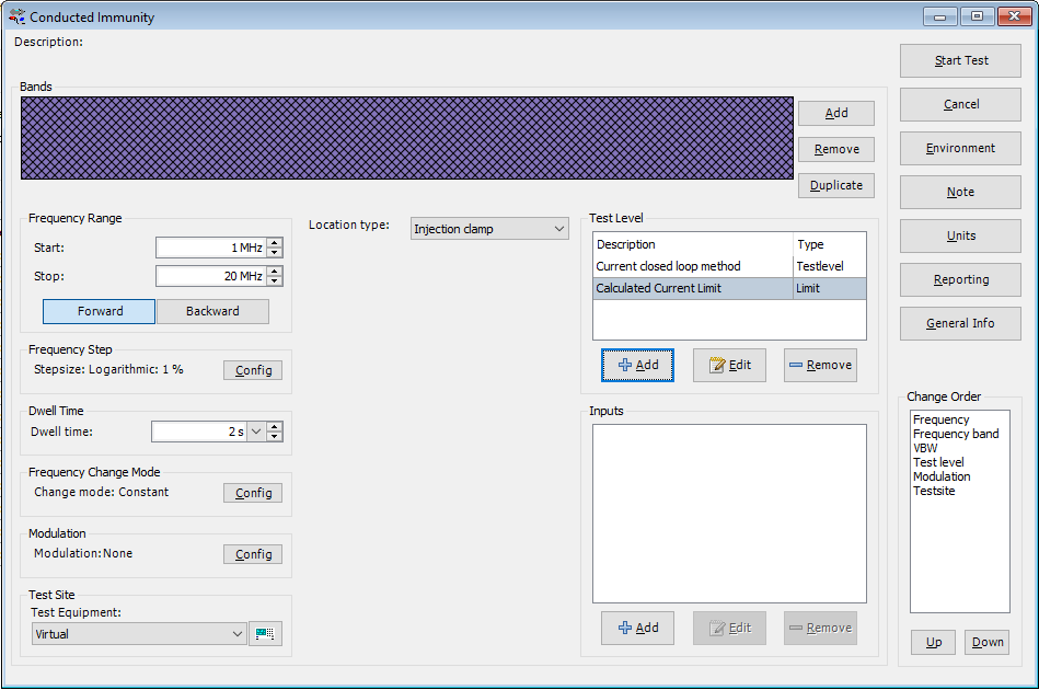

For Closed loop test with power limitation on the DUT, it is important to first open an EUT file in RadiMation. Once the EUT file is opened, the closed loop test can be started by selecting the ‘Tests’ > ‘Conducted Immunity’ > ‘Multiband’ test from the menu in our RadiMation software.

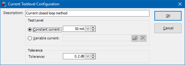

In the Conducted Immunity Multiband test, this can be configured by including two test-levels in the test configuration:
  1. Current closed loop method
    Current closed loop method configuration

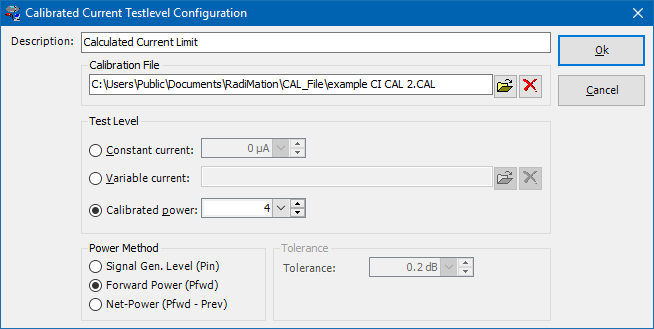

  2. Calculated Current limit
    Calculated current limit configuration
    In this calculated current limit configuration, you can specify the previously calibrated calibration file, and limit the injected power to 4x the calibrated power.
The test configuration, will thus become something like:
Test configuration for the closed loop method accoording ISO 11452-4
Again, please be aware that the test-levels, and frequency range can be different, and is depending on the EUT that should be tested.
Because a current closed loop method is selected, the current will be measured on every frequency. This also causes that the current graph will be available as a graph line, it is not necessary to also include the 'current' in the inputs list.
Because the calculated current limit is included, which a forward power measurement on every frequency. This also causes that the forward power graph will also be available as a graph line, and it is not necessary to also include the 'forward power' in the inputs list.
