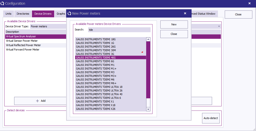

It is possible to use the TDEMI X analyser as a power meter device driver.
Add TDEMI as a power meter
Screenshot 2023-03-30 104822.png (45.78 KiB) Viewed 108413 times
Or are you looking into retrieving the data of a build-in EIRP measurement test of the TDEMI itself and view the results in RadiMation?
