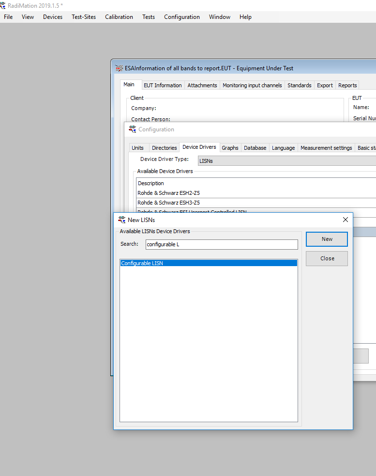

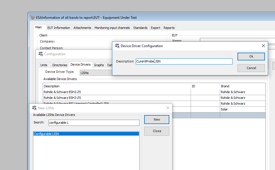

Go to "Configuration/configuration" and open "Device Drivers"
Go to "LISN"
Add "Configurable LISN"
Rename the LISN driver to a appropriate name like: CurrentProbe/LISN
Set the frequency range.
The rest of the settings can be left blank.
Close and save the configuration.

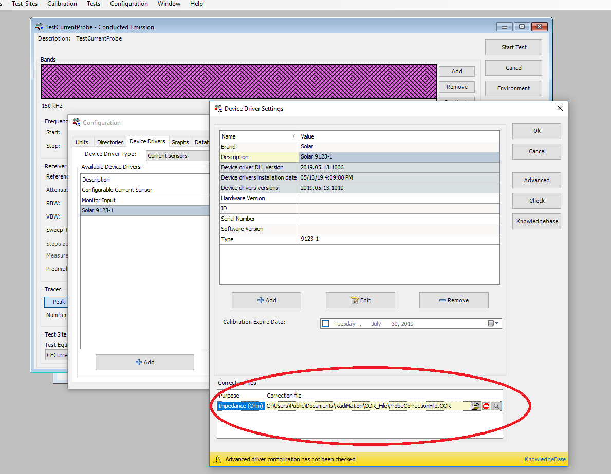

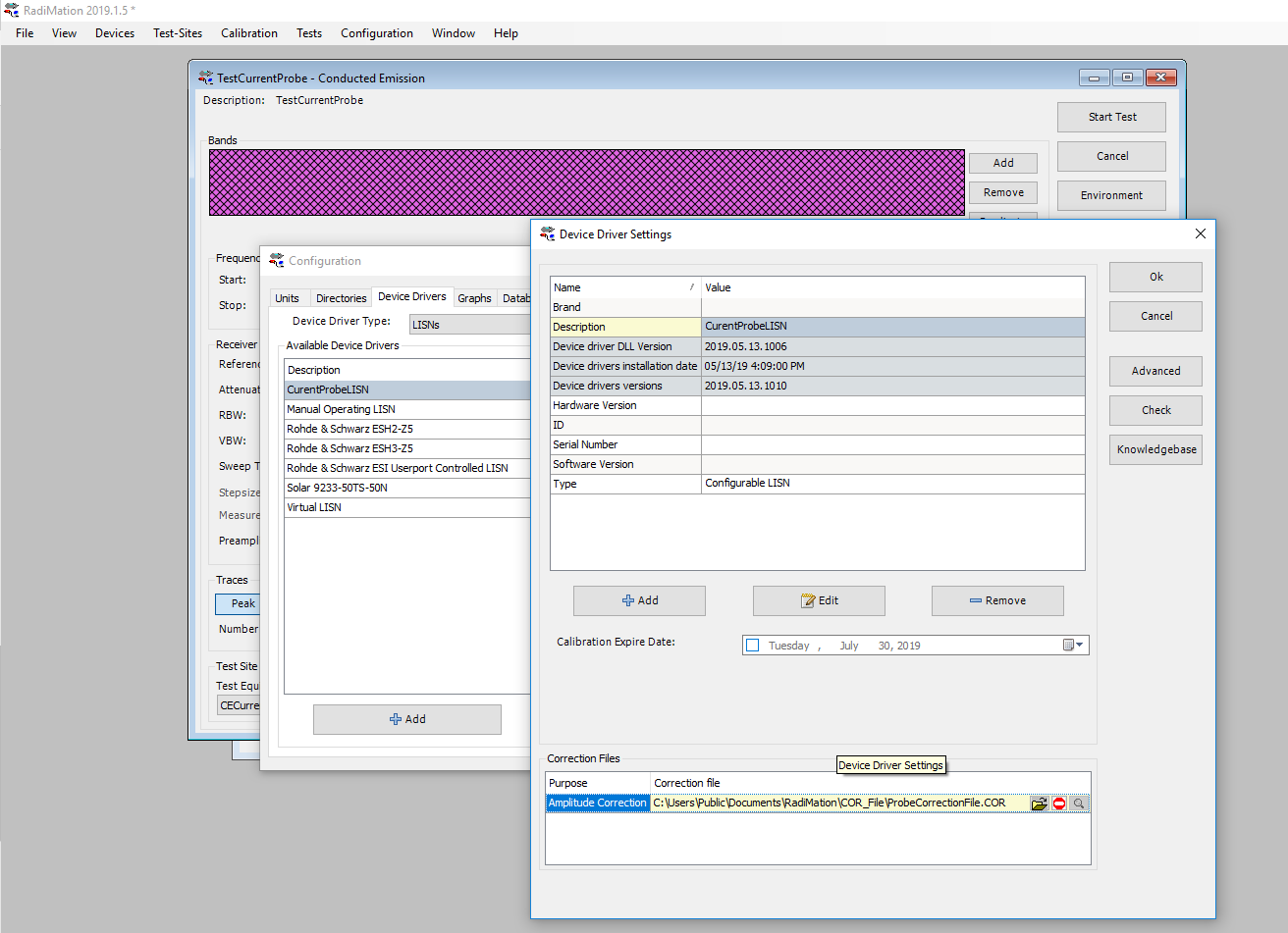

Before we move on lets make sure tat we add our correction file that is normally used with the current probe driver.
Go to your current probe and check which file has been used for correction
Now go back to our LISN driver we just made and add the correction file there. This is very important as the correction is needed for the probe to measure correctly.

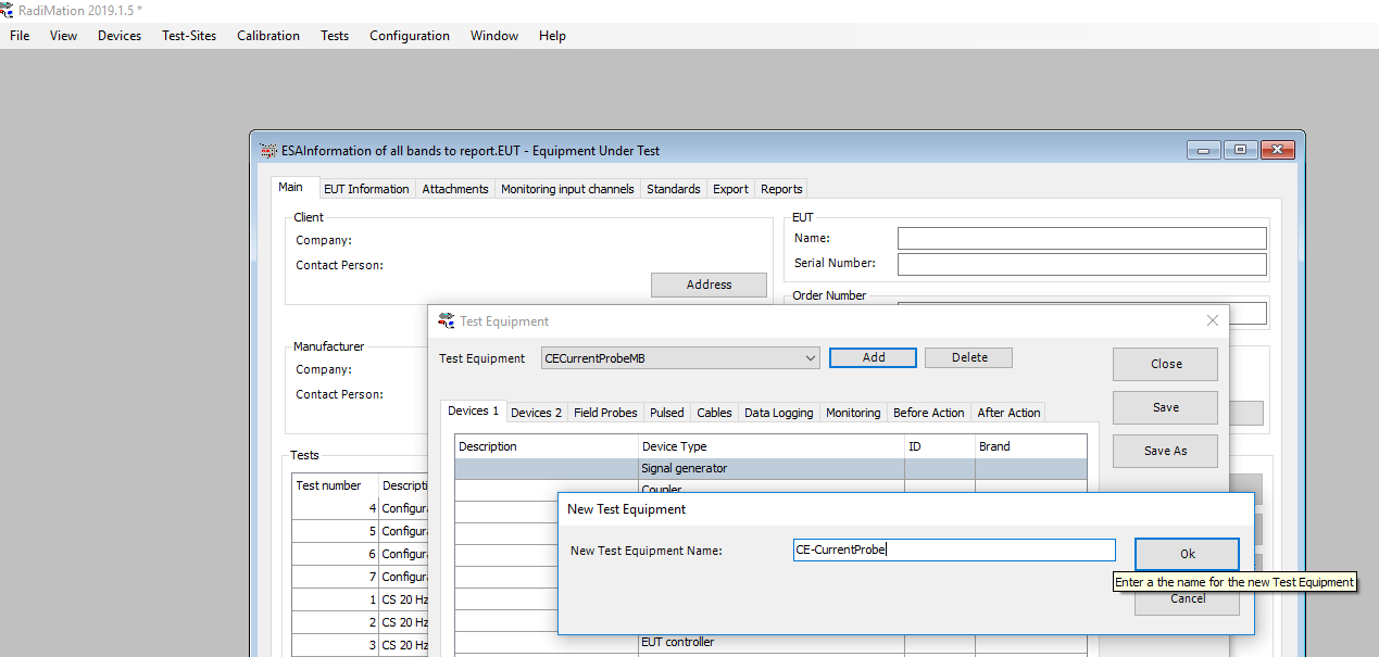

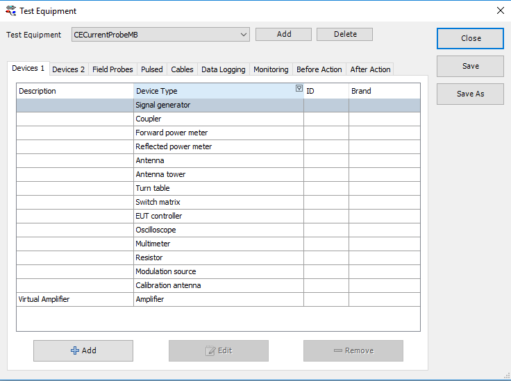

Add a new testsite:

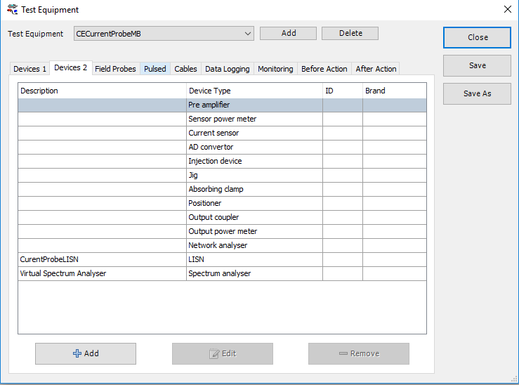

Add your amplifier, analyser/receiver and Current Probe/LISN driver. As the Current probe is now using a LISN driver you need to add it as a LISN.
Your test site should look something like this:
Close and save the test site.
Now we have setup the driver and made a new test site where it is added with all the other devices needed for this test.

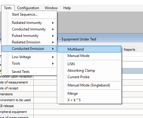

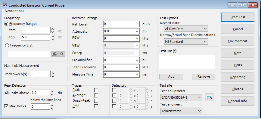

Make a new EUT and go to Tests. Select Conducted Emission -> Multiband

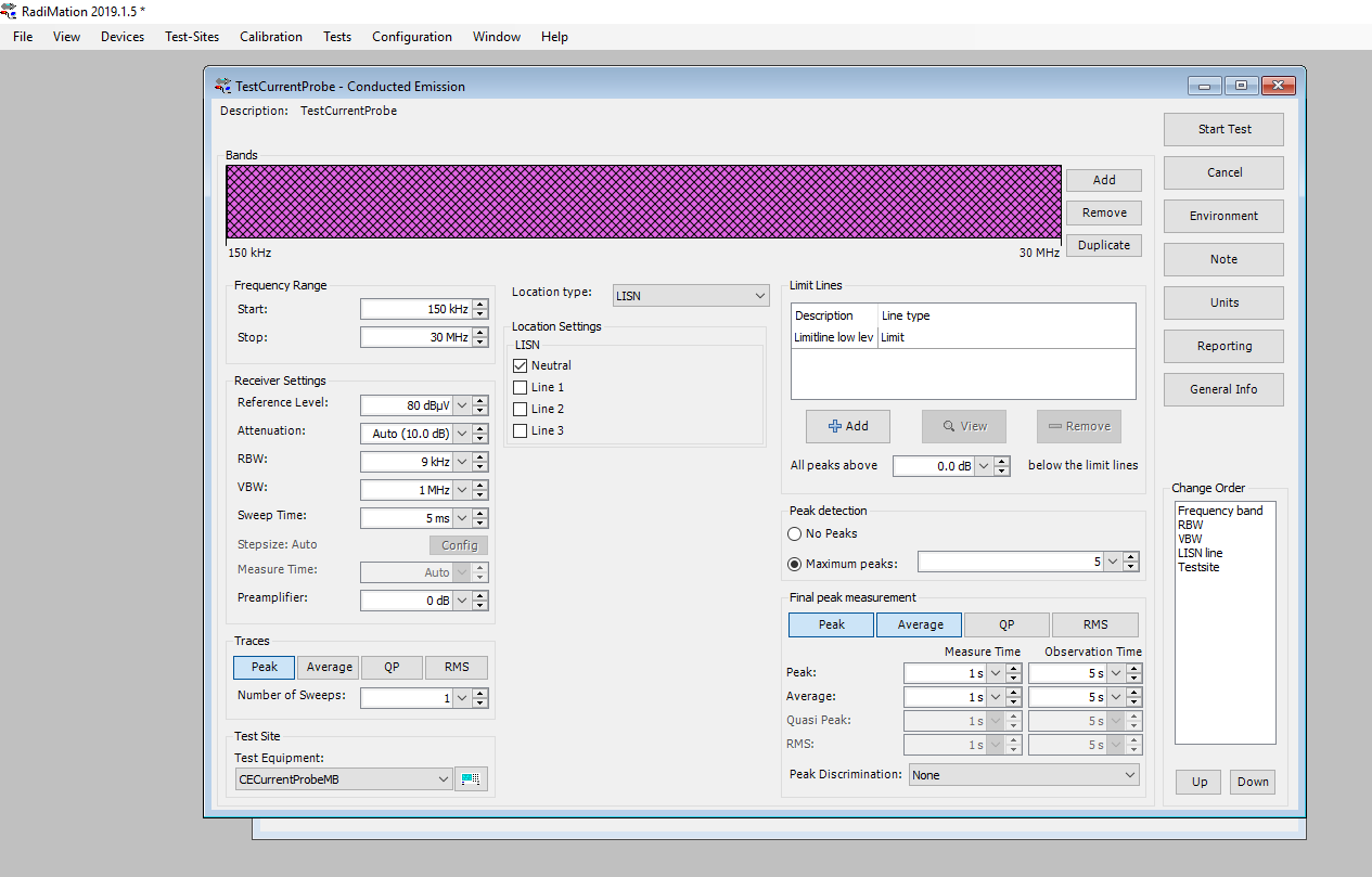

This will open the test set-up window. As you can see, the settings are the same as a normal CE test.
It is important that you turn on at least one of the lines, the easiest is to just check Nutral.
Go to "LISN"

Add a new testsite:
