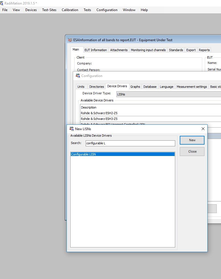

Go to "Configuration/configuration" and open "Device Drivers"
Go to "LISN"
Add "Configurable LISN"

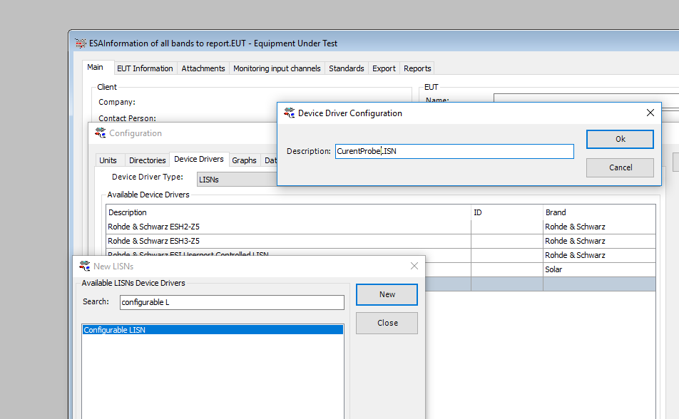

Rename the LISN driver to a appropriate name like: CurrentProbe/LISN
Set the frequency range.
The rest of the settings can be left blank.
Close and save the configuration.

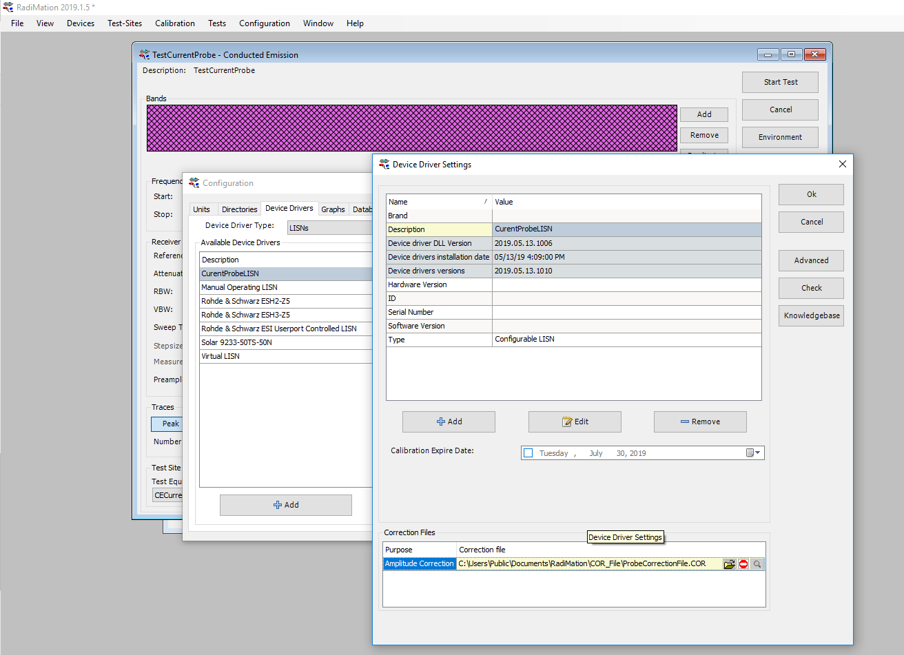

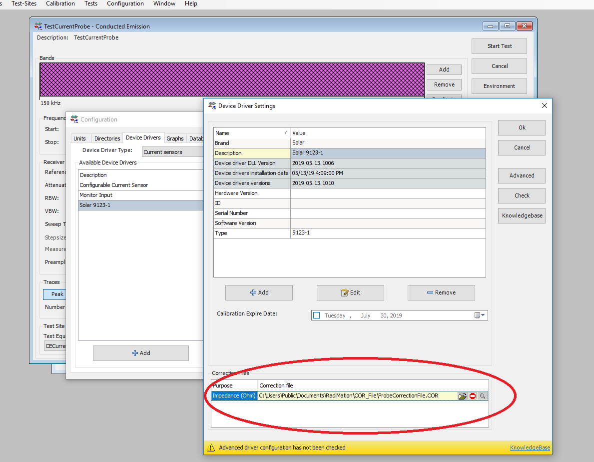

Before we move on lets make sure tat we add our correction file that is normally used with the current probe driver.
Go to your current probe and check which file has been used for correction
Now go back to our LISN driver we just made and add the correction file there. This is very important as the correction is needed for the probe to measure correctly.
CuurentprobeLISN Correction.png (59.53 KiB) Viewed 158961 times

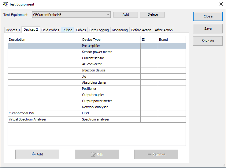

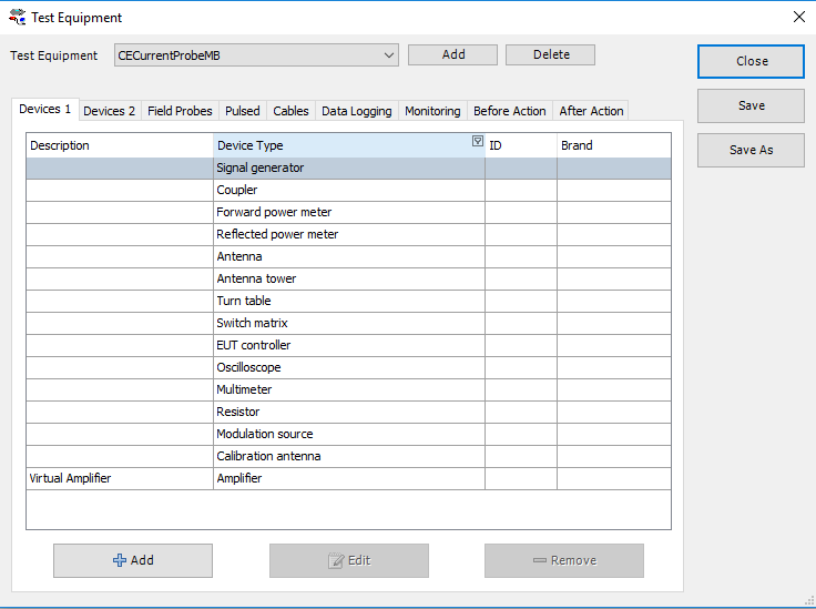

Now our driver is set up correctly. Let's now set up the testsite whith which we can do the tests.
Add a new testsite:
Add your amplifier, analyser/receiver and Current Probe/LISN driver. As the Current probe is now using a LISN driver you need to add it as a LISN.
Your test site should look something like this:
Close and save the test site.
Now we have setup the driver and made a new test site where it is added with all the other devices needed for this test.

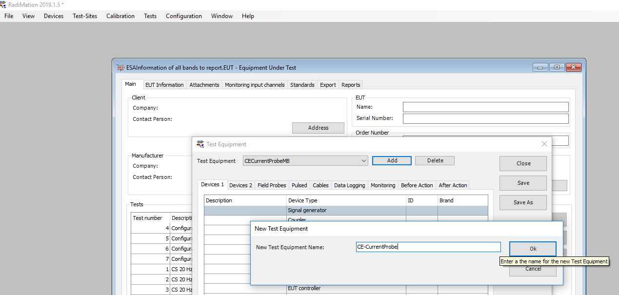

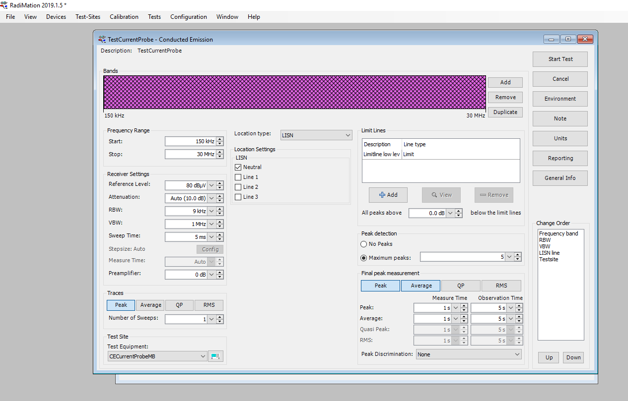

by PhilipM
These are my screen shots

by roge
Dear Philip,
To perform a multiband conducted emission measurement with a current probe, create a new TSF file by choosing "Tests" > "Conducted emission" > "Multiband". When configuring the test make sure to select current sensor as location type, this ensures that the values in the test result are shown in 'current'.
Additionally the current unit can be changed by clicking the 'Units' button:
