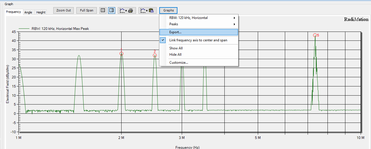

1. Open the reference measurement test result
2. Choose "Graphs"
3. Choose "Export"
Choose Export.PNG (40.85 KiB) Viewed 24251 times

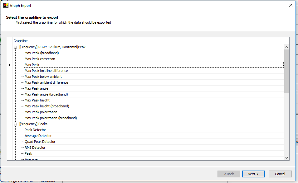

Select the graphline.PNG (26.65 KiB) Viewed 24251 times

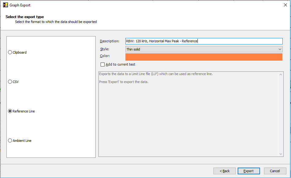

5. Check "Reference Line" on the left side.
6. Make sure to rename the file and choose a different colour.
7. And save the file as a LLF file by clicking "Export".
Save as reference line.PNG (18.46 KiB) Viewed 24251 times

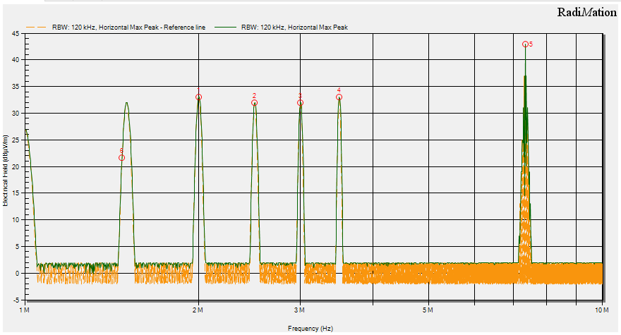

Then, when a new test is started, this exported reference line can be used by adding it as a limit line.
Note: for reference lines no max hold is done, so all measured values are visible, this seems odd but it is still usable to compare against other measurements.
