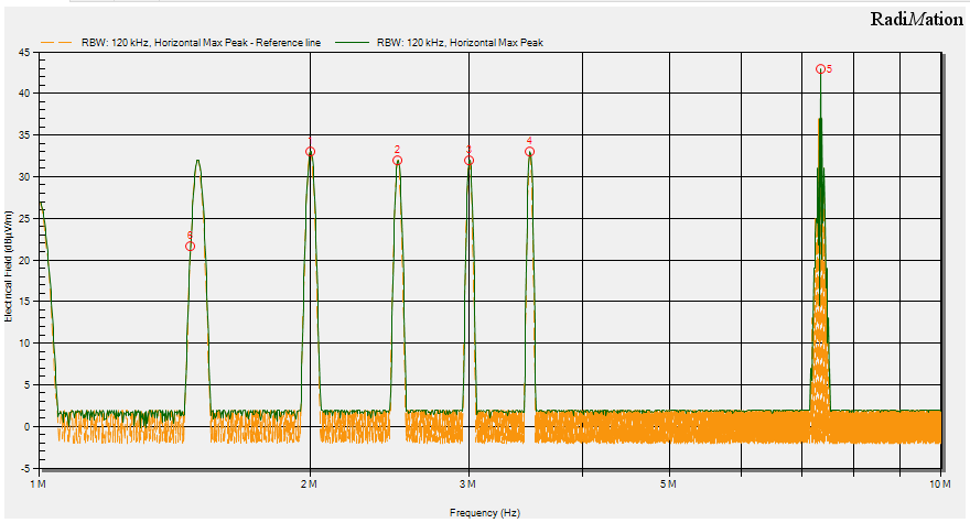

Could you please explain how to compare a measurement against another previously executed measurement?
I want to compare the data before and after the calibration of my analyser.

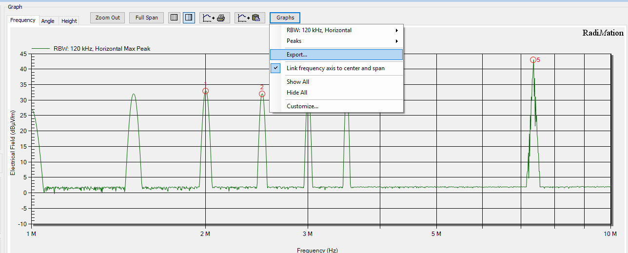

1. Open the reference measurement test result
2. Choose "Graphs"
3. Choose "Export"

Choose Export.PNG (40.85 KiB) Viewed 24255 times

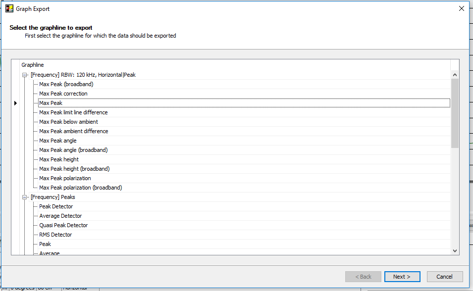

4. Choose the line to use as a reference line.
Select the graphline.PNG (26.65 KiB) Viewed 24255 times

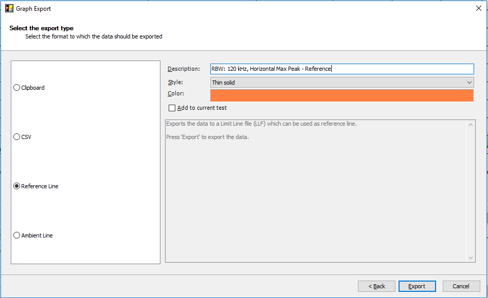

5. Check "Reference Line" on the left side.
6. Make sure to rename the file and choose a different colour.
7. And save the file as a LLF file by clicking "Export".
Save as reference line.PNG (18.46 KiB) Viewed 24255 times
Then, when a new test is started, this exported reference line can be used by adding it as a limit line.
Note: for reference lines no max hold is done, so all measured values are visible, this seems odd but it is still usable to compare against other measurements.
