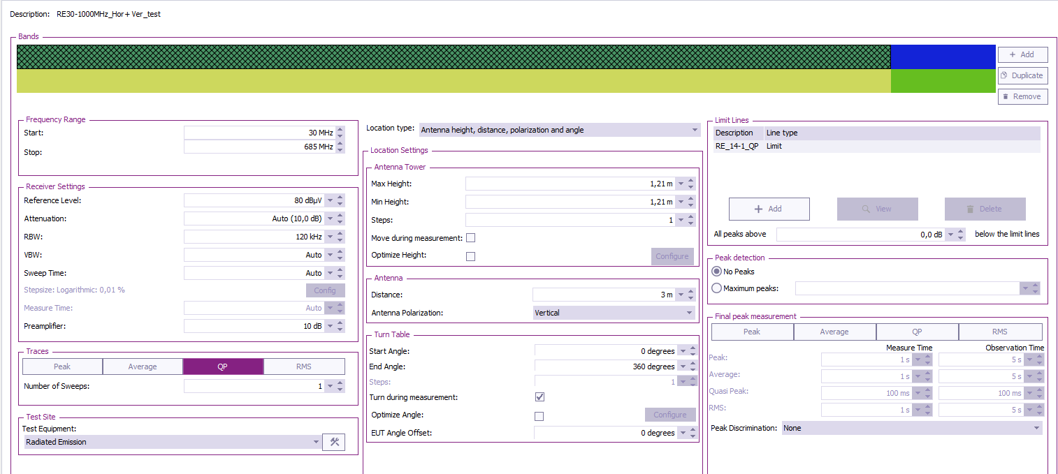

I have done all relevant settings now and the measurement itself is working fine, but i recognized the following:
1. Measuring with EMI64k:
The measurement is done in spectro mode from 30MHz-685MHz and then from 685MHz-1000MHz. The measurement in each step (30-685MHz) is done in "realtime" with max hold during the rotation of the turntable. So at the end I have nearly at all turntable angle a measurement result. --> very good
2. Measuring with Radimation

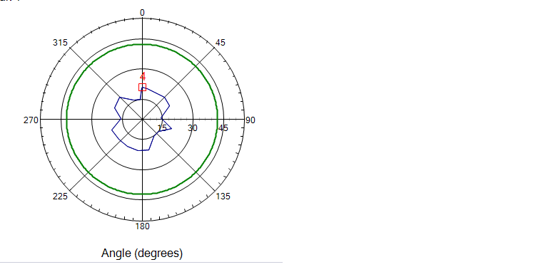

Attached is a screenshot from the TSF. So the measurement procedure is same as in EMI64k. BUT Radimation is only updating the results each ~4s (not in "realtime"). Means at the end I have only for all eg. 30° a measuring result and the angle diagram is looking very rough.
anybody an idea how to solve this issue?

Our RadiMation software is not using the 'realtime spectrogram mode' of the Gauss TDEMI, because our 'turn turntable during measurement' algorithm is using the additional information that is received by taking individual sweeps to optimize the turntable angle optimization.
It is thus indeed correct that RadiMation starts a sweep on the TDEMI in analyzer mode, transfers the sweep, and then starts a new sweep, which is then transferred to the PC again. During the transfer of the measurement results there is indeed a short period of time that no measurement is being performed.
We now understand that in your situation the transfer of the data is taking a considerable amount of time (roughly between 3 and 4 seconds?), which indeed results in the situation that different values on the polar plot are only shown every 30 degrees.
My first reaction is, that the time to transfer the data is indeed taking to long. I know other end-users that are using the TDEMI which have measurement update intervals of less than 1 second. The problem however is that this transfer time is not only caused by the used spectrum analyzer but is also depending on the communication speed with the turntable controller.
We do want to investigate this problem for you. And there is a high chance that we will be able to improve the time that is needed to transfer the data.
Please perform a measurement again, and then send us an ErrorReport. The error report will contain the communication log with the TDEMI and the turntable including all the timing information, and we will be able to determine what is causing the time delay.
