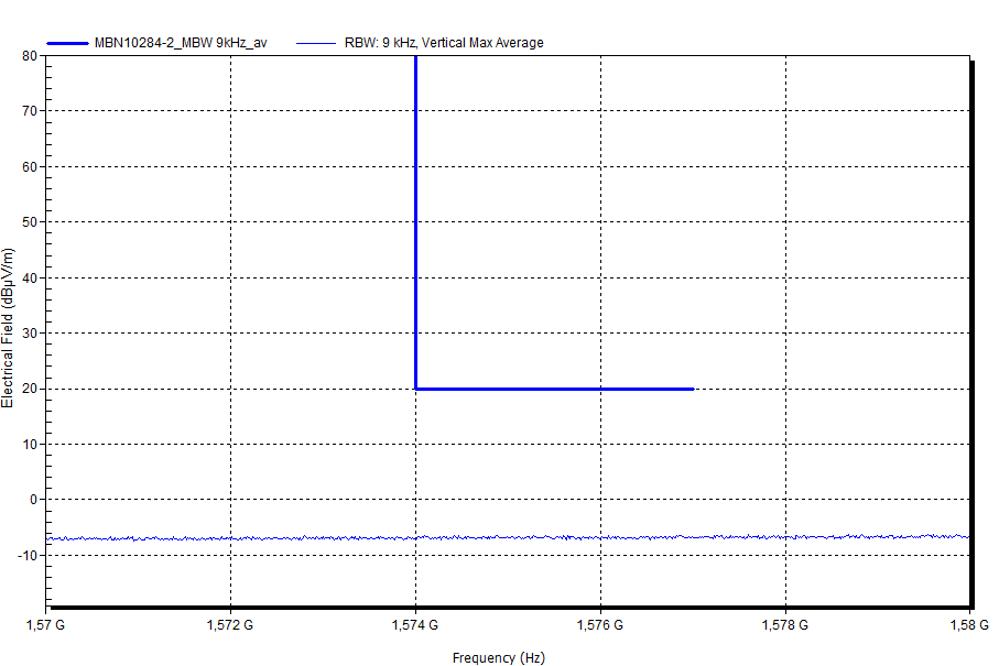

can you tell me wich code is necessary to get this graph in the report?
Marius
Commands for Test specific traces emission multiband
- Unbenannt.png (20.54 KiB) Viewed 10657 times
Re: Commands for Test specific traces emission multiband
Hello Marius
To include any multiband graph in a report, you can just use the name of the graph line as the keyword in the report template. So in your case ||RBW: 9 kHz, Vertical Max Average||. Any related limit line will also be automatically added.
Also see: http://wiki.dare.nl/wiki/index.php/Comb ... n_a_report
Hello John,
ok it works but: I would like to have the X-Axis scaled only to the measured frequency range and not to the limit line range... See the attached file for example. Is it possible without change of the limit line?
Greetz Marius
Greetz Marius
