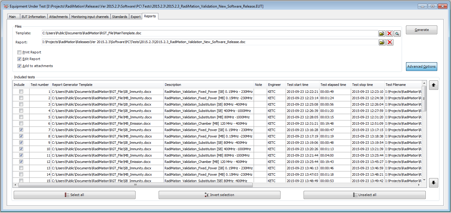

In my previous reaction I described some new functionality that we could implement in RadiMation to provide a solution for your problem.
There is however also another already working possibility that could be sufficient for you. In this reaction I would like to describe that functionality, I am not sure if you have tried this, or are aware of this.
The RadiMation report generator has the possibility to use test specific templates in combination with a main template.
This is described at: http://wiki.dare.nl/wiki/index.php/Chap ... _templates
By creating and linking a test-specific template to each relevant test, the test-specific template will be simpler and only include the information of that test.
The main-template allows to provide the general information of the report, and to specify the positions on which the test specific templates should be included/merged.
The advantage of this method regarding your problem, is that it allows you during the start of the report generator to specify which tests should be included, and which not.
See the screenshot below, and notice that only a selection of all the available tests is marked to be included in the final report. I hope that this gives you another idea of what is possible. Hopefully it allows you to find a correct working solution. If you have some questions, regarding this, please let us know.
Regards,
Regards,

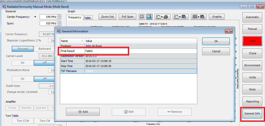

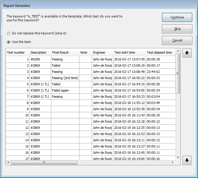

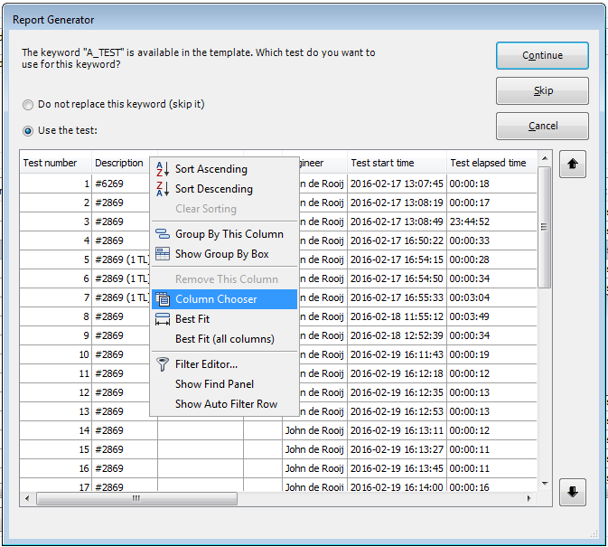

And I have another trick I would like to share with you, making it easier to select the correct test for the report generator.
It is possible to create your own field by 'Add'-ing a 'General Information'. In the screenshot below I have added a 'Final Result' field, which I used to document the final result of the test. When a report is generated, and a report generator keyword is present for multiple tests, the dialog for the selection of the corresponding test is shown.
In this dialog it is also possible to show the custom field as a column. If a column is not visible initially, the column can be made visible by right-clicking on the column header, and selecting 'Column Chooser'. Then the desired columns can be dragged and dropped to the column headers.
Once the 'Final Result' column is visible, it maybe easier to select the correct test.
It is even possible to sort the column (by clicking on the column header), and to filter on the column contents.
In this example I used a 'Final Result' field, but it is possible to add your own fields, and to use multiple fields.
I hope that this gives you another idea on how to simplify the usage of RadiMation to generate the final report.
Best Regards,
