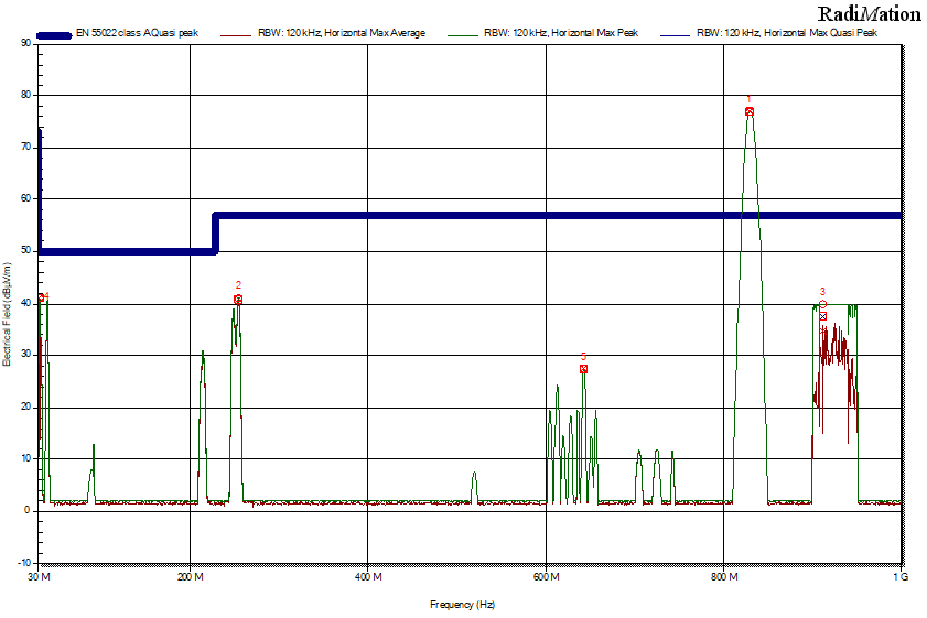

To include the complete emission graph, you can use the following code:
||MAX HOLD PEAKS GRAPH||
This will result:

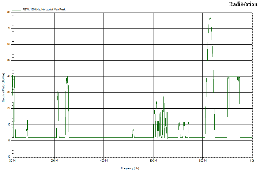

If you however would like to use separate graphs for the different graph lines, just use the real graph line names as the code.
||RBW: 120 kHz, Horizontal Max Peak||
Will only show the peak prescan graph only:

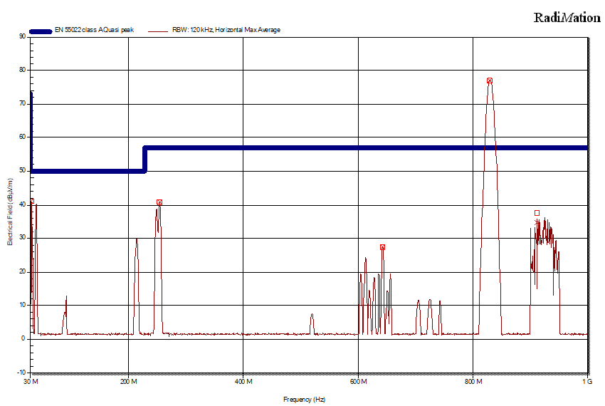

Multiple graph lines can also be combined by ;-seperating them:
||RBW: 120 kHz, Horizontal Max Average; EN 55022 class A Quasi peak||
will show the average trace prescan graph with the limitline:

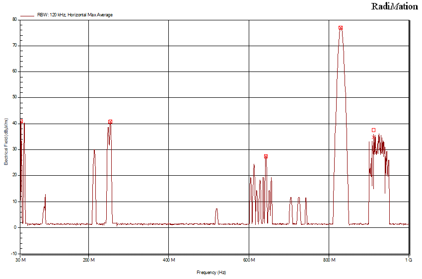

The names in that last shown popup menu are also the graph names. Just to show the quasi peak final measurement markers, just include 'Quasi Peak' as graph name.
||RBW: 120 kHz, Horizontal Max Average; Average; Quasi peak||
Will thus show the Average graph line, with the Average and Quasi peak markers:

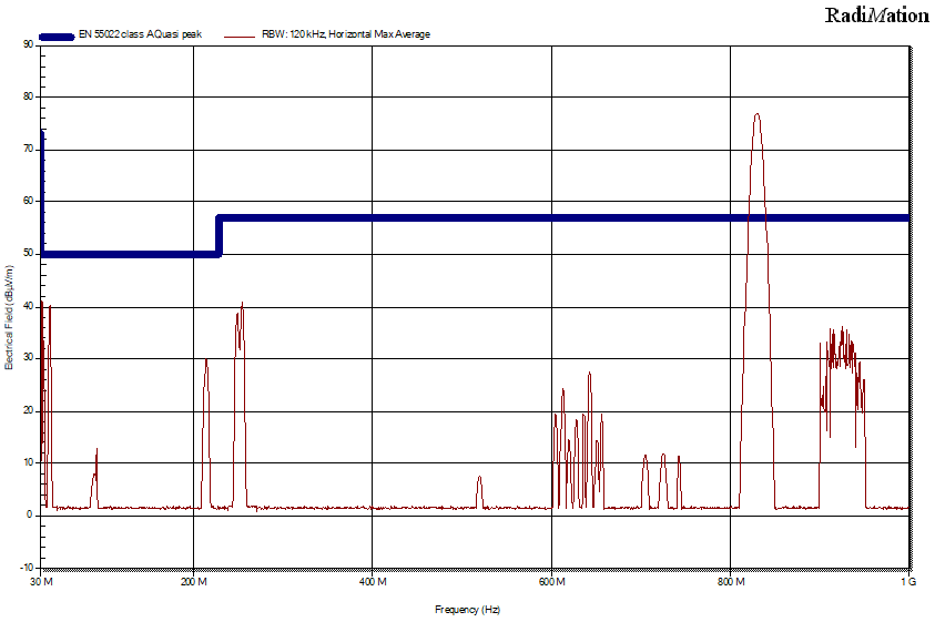

||RBW: 120 kHz, Horizontal Max Average; Average; Quasi peak; EN 55022 class A Quasi peak ||
Will then also include the limit line:
