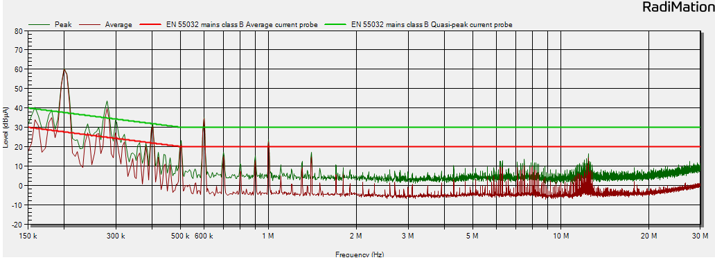

I want to use the report generator to export current probe conducted emission measurement results, specifically the graph. See below a screenshot of the graph.
I want to export a graph 150 kHz - 30 MHz, with result lines Peak and Average, and limit lines EN 55032 class B Average current probe and EN 55032 mains class B Quasi-peak current probe
Code: Select all
|| TEST1|Peak; Average; EN 55032 class B Average current probe; EN 55032 mains class B Quasi-peak current probe||
Writing the code like this works when I export data from a multiband test, but the current probe measurement does not work with this code in the RG.
How can I fix the RG template so I can export the graph?
Thanks.

It should be possible to export the graph shown for the current probe emission test by using the keyword ||GRAPH||
I hope to have informed you for now,
