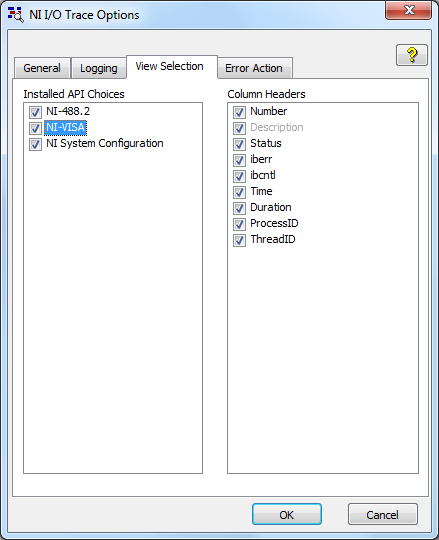

It is also possible to use the NI-SPY program to capture RS-232 communication. However there are some requirements for this to be working:
  • NI-VISA should be installed
  • NI-SPY should be configured to capture RS-232 communication, by activating the 'NI-VISA' API on the NI-SPY Options dialog (see the screenshot below)
  • The RadiMation device drivers should be newer than 2013.1.1. Because these newer device drivers will automatically take benefit of the installed NI-VISA layer to perform RS-232 communication.
If you have some problems with the capturing of RS-232 communication in the NI-SPY programs, one of the above requirements are probably not fulfilled.
The big advantage of using the NI-SPY program, is that this is also working on 64-bit operating systems. The Portmon program is not working on 64-bit operating systems.
NI-SPY Options dialog, activating the NI-VISA API

Thank you for your answer, much appreciated. Indeed that was my problem, because my operating system is x64 I was not able to make use of the Portmon program. Now it seems to work fine for me capturing with NI-Trace.
