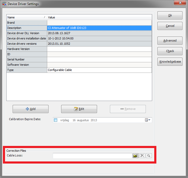

Go to MENU->DEVICES->CONFIGURE... Now select the Device driver type ‘Cables’ from the drop-down menu. Click the ‘New’ button on the bottom of this window. Select the ‘Configurable Cable’ from the list and click the ‘New’ button (or double click from the list). Now type the name e.g. “CI Attenuator of 10dB ID0123” and click ‘Ok’. Double click this name from the list and you’ll see this window:
Add your correction file.
