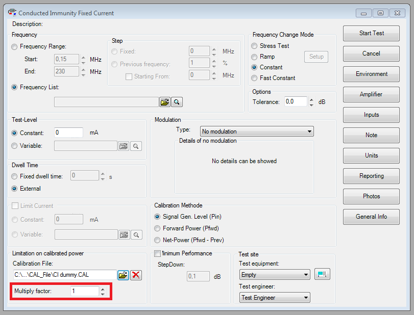

When we want to perform a Conducted Immunity Fixed Current test it is possible to make use of a Multiply factor for the Test level Limitation, as can be seen from the screenshot below.
How can we set the configuration of this setting using the Multiband test?

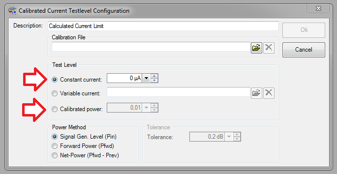

This is possible by opening the Conducted Immunity Multiband test and Click the "Add" button under the "Test Level" list. A new window with a list of Test Levels and Limits will be shown.
Now select from this list the Limit "Calculated Current Limit". The following window will be opened:
In the Test Level box it is possible to fill in a "Constant Current' which can be x times the desired Test Level. It is also possible to fill in a x amount of "Calibrated Power".
This will correctly limit the Test Level used during the test.
