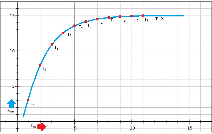

Power meter graph sketch - Copy.png (15.57 KiB) Viewed 48455 times
When we use the same settings as in the previous posts, except for the wait time (we now use 1ms), then we are able to define the following statements:
  • The first measurements will consist of T1, T2 and T3, because the <Measure> (minimum) value is set to 3
  • The time difference between these measurements will be at least 1ms
  • The difference is determined between T3 (highest) and T1 (lowest)
  • This difference value is NOT WITHIN the defined max. difference of 0.1dB, and is also not exceeding the Max. Measure, therefore;
  • Measurement T4 is performed
  • The measurements now consist of T2, T3 and T4 (T1 is now neglected)
  • Again, the difference is determined, but now between T4 (highest) and T2 (lowest)
  • Again, this difference value is NOT WITHIN the defined max. difference of 0.1dB, and is also not exceeding the Max. Measure, therefore;
  • Measurement T5 is performed
  • The measurements now consist of T3, T4 and T5 (T1 and T2 are now neglected)
  • Again, the difference is determined, but now between T5 (highest) and T3 (lowest)
  • Measurement T6 is performed
  • The measurements now consist of T4, T5 and T6 (T1, T2 and T3 are now neglected)
  • Again, the difference is determined, but now between T6 (highest) and T4 (lowest)
  • Measurement T7 is performed
  • The measurements now consist of T5, T6 and T7 (T1, T2, T3 and T4 are now neglected)
  • Again, the difference is determined, but now between T7 (highest) and T5 (lowest)
  • Measurement T8 is performed
  • The measurements now consist of T6, T7 and T8 (T1, T2, T3, T4 and T5 are now neglected)
  • Again, the difference is determined, but now between T8 (highest) and T6 (lowest)
  • Measurement T9 is performed
  • The measurements now consist of T7, T8 and T9 (T1, T2, T3, T4, T5 and T6 are now neglected)
  • Again, the difference is determined, but now between T9 (highest) and T7 (lowest)
  • Measurement T10 is performed
  • The measurements now consist of T8, T9 and T10 (T1, T2, T3, T4, T5, T6 and T7 are now neglected)
  • Again, the difference is determined, but now between T10 (highest) and T8 (lowest)
  • Still, this difference value is NOT WITHIN the defined max. difference of 0.1dB, however;
  • The <Max. Measure> value is reached and 10 measurements are performed, so no new measurements are taken, therefore;
  • The average measurement value of the last set of performed measurements is used as the correct measurement value, thus the average of measurements T8, T9 and T10 is returned as final value.
