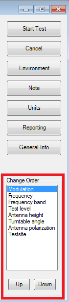

We are wondering if it is possible to perform Radiated Immunity using two different types of modulations (AM and PM) in the same sweep.
With this setting we could save time during the test, because the leveling is performed only once.
Re: Multiple modulation forms during Radiated Immunity test
Posted: 20 Mar 2014, 13:06
Yes, this should already be possible in the 2013.1.x and higher versions of RadiMation by using the Radiated Immunity Multiband test.
It is needed to configure two bands whereby each band has it's own modulation type. E.g. the first band with the AM modulation settings and the second band with the PM modulation settings. The frequency range of both bands are the same.
You now have to modify the "Change order" and place the "Modulation" parameter on top of this list.
By placing this 'modulation' above the 'frequency' in the change-order, both modulations will be tested in the same sweep.
