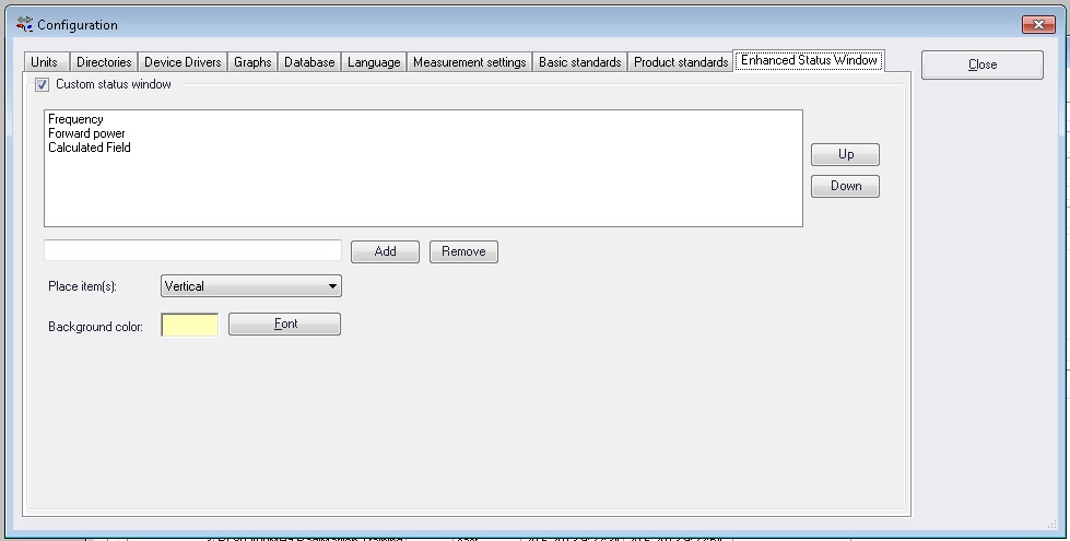

RadiMation already contains a solution for this problem.
It is possible to configure RadiMation in such a way that a several measurement parameters are shown in a larger font on a customized location.
This functionality is called "enhanced status window", and can be configured in the RadiMation configuration dialog.
See the following screenshot.
Enhanced Status Window configuration
The textbox before the 'Add' button can be used to specify the name of a measurement parameter. By pressing the 'Add' button the measurement parameter will be added to the list above it. All the measurement parameters that are included in the list will be shown during the test in a seperate window.
The 'Font' button can be used to specify the font, the color and the size of the text in which the measurement parameters will be shown. The colored box behind the 'Background color:' will be the background color of the window in which the measurement parameters will be shown.

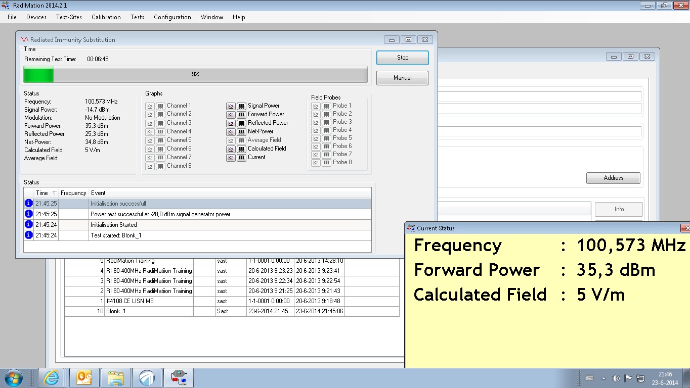

With the above configuration, during a test the 'Current status' window will be shown, which includes the specified measurement parameters. See the following screenshot for the result during the test.
Bigger measurement parameters during the test
