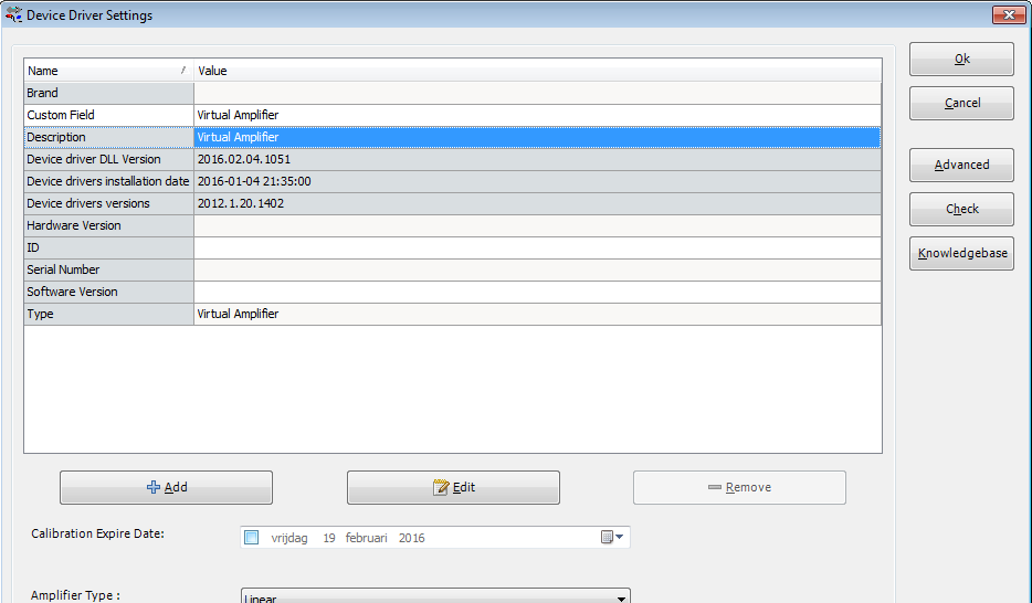

Dear Radimation support,
Is there any Keyword to get the 'Device drivers versions' in the RG? I have seen this topic viewtopic.php?f=15&t=116 and the links it references, but I cannot find a Keyword for the RG. Also in http://wiki.dare.nl/wiki/index.php/Chapter_13 I could not find it, only the specific driver versions for each instrument.

There are indeed report generator keywords to get the 'Device Drivers versions' information into the report.
Assume that the following information is available in a device driver configuration:
Device driver settings, including a 'Custom Field'.
Every entry that is included in the additional device driver information can be retrieved. The code to retrieve it is: ||<TEST>|<DEVICE_USAGE> EXTRA INFORMATION <INFORMATION_FIELD>||

It is even possible to get any field that is manually added. In the above screenshot also the 'Custom Field' is available. The corresponding report generator keyword is:
AMPLIFIER EXTRA INFORMATION CUSTOM FIELD: ||A_TEST|AMPLIFIER EXTRA INFORMATION CUSTOM FIELD||
I hope that this clarifies what is possible, and this answers your question.
