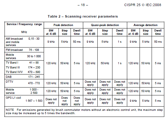

The Customer needs to perform measurements according to CISPR 25 with settings reported below:
CISRP25 Table 2
CISRP25 Table 2

If I understand it correctly, the customer would like to perform measurements according to CISPR 25 using the Agilent/Keysight N9038A.
The customer is referring to table 2 as it is part of the CISPR 25 Edition 3.0: 2008
CISRP25 Table 2
CISRP25 Table 2
Based on settings of the RadiMation TSF configuration, the customer is performing a test using the settings:
Frequency range: 100 – 150 MHz
Step frequency: 50 kHz
RBW: 120 kHz
Measure time: 5 ms
Trace-detector: QP
Based on these settings, 1001 individual frequencies in the 100-150 MHz range will be measured. In combination with a measure time of 5 ms, an expected total measurement time of 1001 * 5 ms = +- 5 seconds can be expected.
However the settings in the TSF are different from what is required from the Table 2 from CISPR 25. In Table 2 there is no specification for the frequency range of 100 MHz- 150 MHz at all. And also in Table 2 there is an explicit specification of a minimum dwell time (which is measure time) of 1 second for the Quasi Peak detector.
The reason for the minimum dwell time of 1 second for the Quasi Peak detector is logical, as the principle working of the quasi peak detector needs some time to determine the correct measurement value. The correct setting for the measure time in RadiMation is thus 1 second. The total measurement will then take 1001 * 1 second = 1001 seconds = +- 17 minutes.
I also expect that the Agilent/Keysight N9038A doesn’t allow to use the QP detector in combination with the 5 ms measure time. And based on that I expect that the N9038A will require more time (at least +-17 minutes) to perform the measurement with the QP detector. In discussions I have had with Agilent/Keysight, I have learned that the minimum effective measurement time for an EMI compliant detector is 1.4 second in the N9038A. Thus in the configuration as configured by the customer, the N9038A probably requires 1001 * 1.4 seconds = 1401.4 seconds = +- 23.4 minutes.
I hope that this explains why the measurement takes longer than expected.

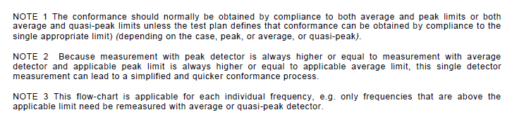

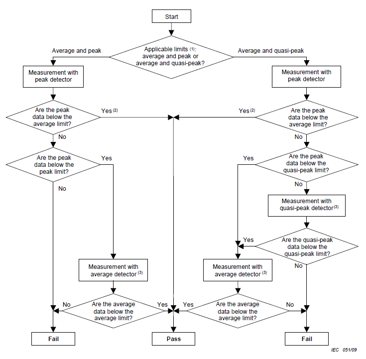

As it is described in section 4.1.3 of CISPR 25, it is allowed to perform the measurement using the Peak detector, and only measure those frequencies with a Peak-detector value that are above the QP limit, using the QP and/or Average detector.
CISPR25 Measurement flowchart
CISPR25 Flowchart notes
It is explicitly described in Note 3 that this flowchart should be interpreted for each individual frequency, and only those individual frequencies that are above the Peak limit should be re-measured using the QP and/or Average detector.
This is not a problem at all to be configured in RadiMation.
