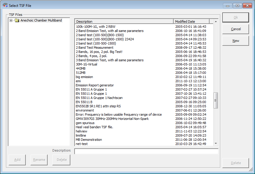

How do you rename a TSF file? When I pull the entry up under the test tab the rename button is greyed out

The 'Rename' button on the TSF File Selection window is used to Rename folder names in the folder-tree on the left side of the TSF File selection window. (also the 'Add' and 'Delete' buttons are used as operations on the folder-tree)
To rename a TSF it is best to open the TSF, and then select from the 'File' menu: 'Save TSF As...'.
