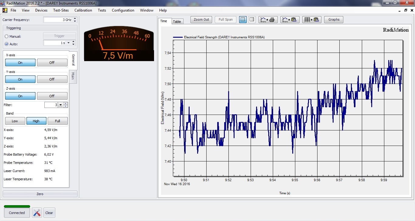

Graphical display of 10 minute auto triggered measurement

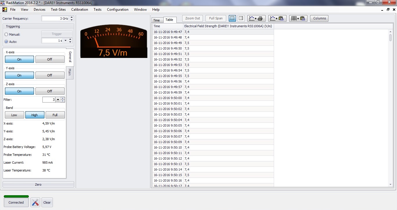

All measurement values are also available in a table

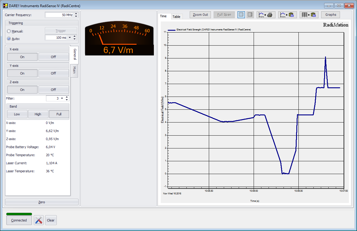

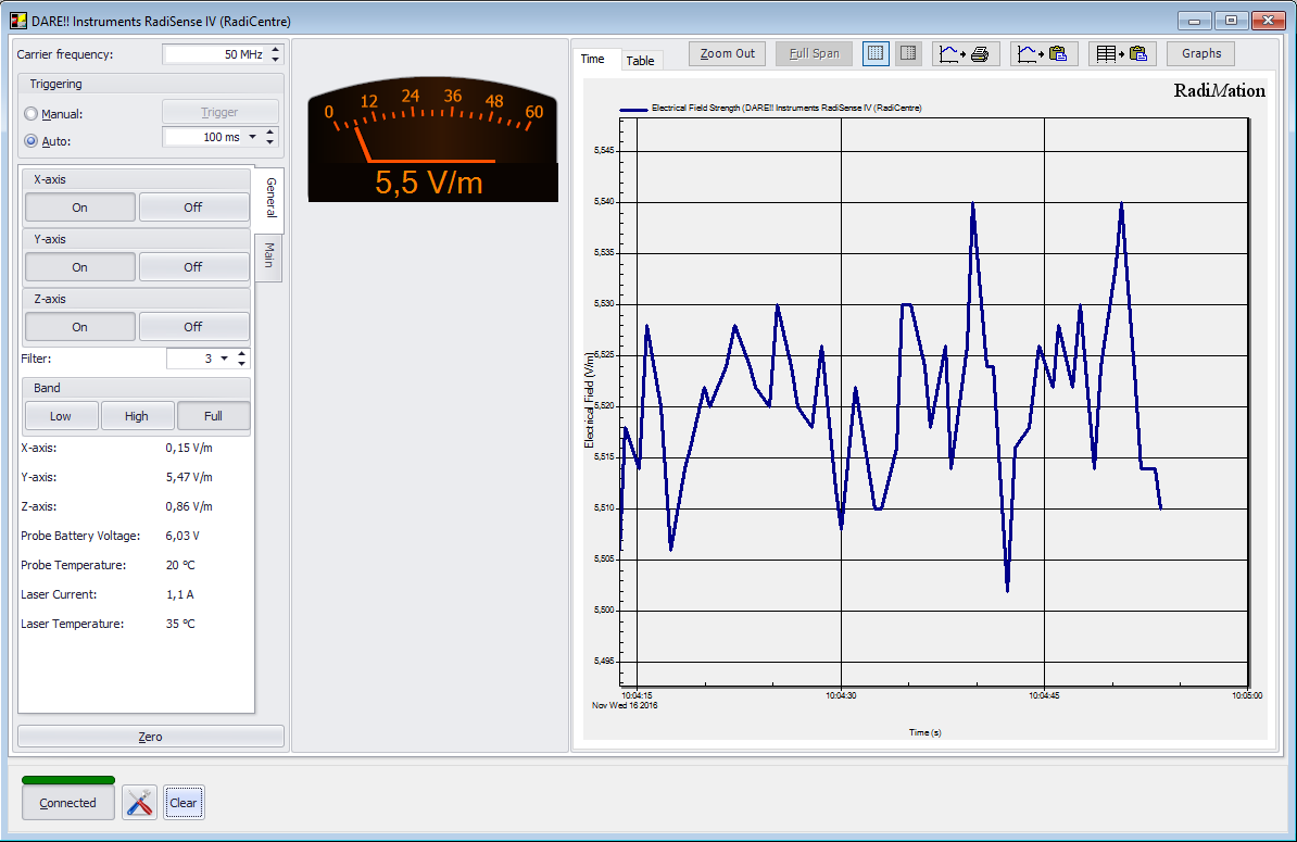

Graphically showing variations in the field strength

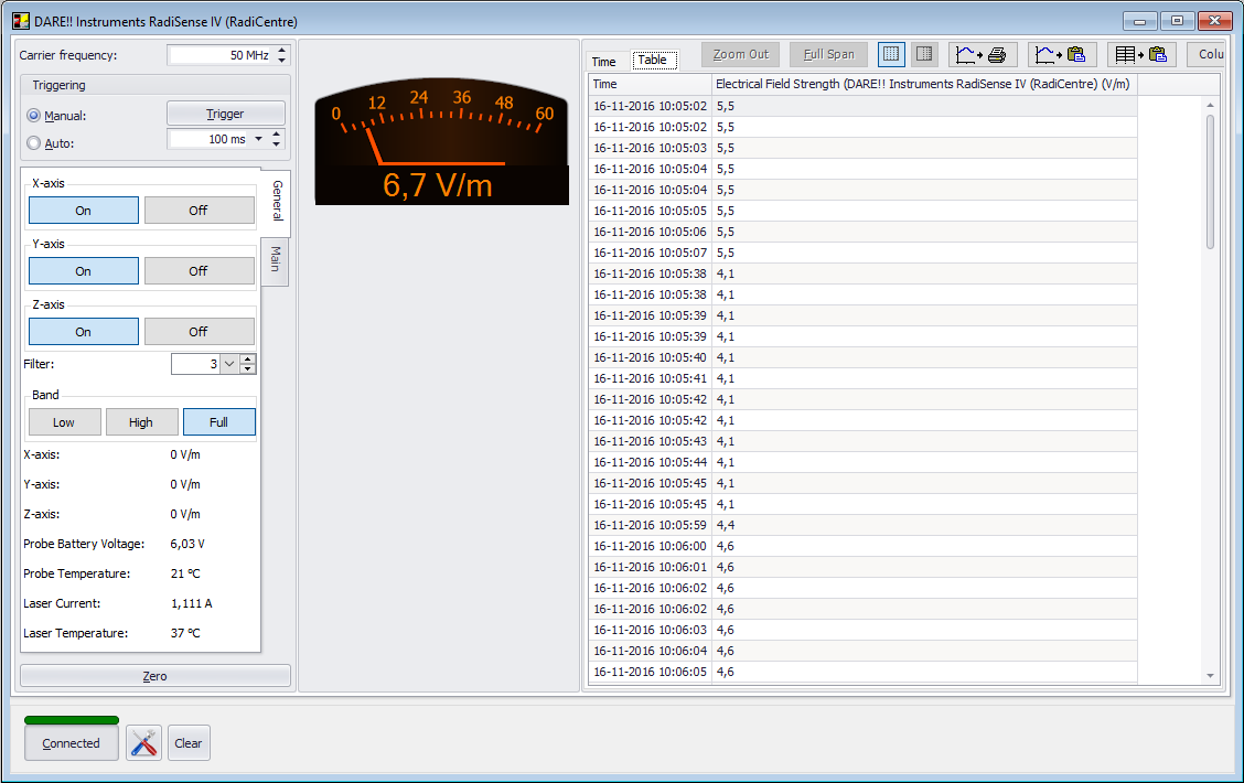

Measurement values shown as a table

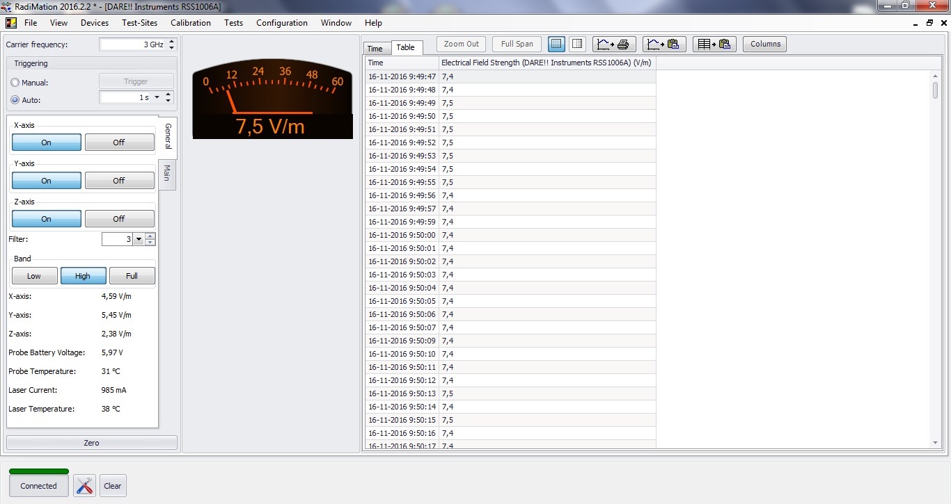

Field probe monitoring and control window in RadiMation Free
