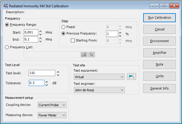

The Magnetic field calibration can be performed in RadiMation by starting the Calibration > System Calibration > Radiated Immunity > Mil Std Calibration.
The 'Coupling Device' and the 'Measuring Device' allow to select the components that are used to measure the current through the magnetic field generation loop.
If as the 'Measuring device', the 'Power Meter' is selected, the device should be selected in the testsite as the 'Sensor powermeter'.
The magnetic field generation loop antenna (for example the ETS-Lindgren: Model 7605 ) should be selected in the testsite as the 'Antenna'.
The magnetic field monitoring antenna (for example the ETS-Lindgren: Model 7606) should be selected in the testsite as the 'Calibration antenna'. This antenna device driver should have a 'Magnetic Field Factor (dBpT/uV)' correction file selected as the third correction file in the device driver settings of the antenna device driver. ( also see: http://wiki.dare.nl/wiki/index.php/Chap ... correction )
The measurement receiver connected to the field monitoring antenna should be selected in the testsite as the 'Spectrum Analyzer'.
It is optional to also attach a 'Magnetic Flux Density' correction file as the second correction file in the device driver settings of the magnetic field generation loop antenna. The correction file should include a frequency column and a correction column, where the values in the correction column are expressed in 'pT/A'. (also see: http://wiki.dare.nl/wiki/index.php/Chap ... correction ). In the MIL-STD 462D, this correction value is specified as 9.5x10^7 pT/A. This 'Magnetic Flux Density' value is used to determine the calculated magnetic field based on the measurement of the current flowing through the magnetic field generation loop antenna.
TSF Configuration of the MIL-STD RS101 Calibration
During the calibration for each frequency, the power level is regulated to the desired magnetic field level as it is measured by the 'Spectrum Analyzer' and the 'Calibration antenna'. When the calibration is performed and finished, the calibration results can be stored to a .CAL file.

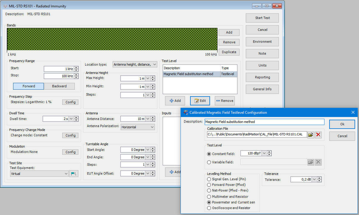

Just use a Radiated Immunity Multiband test, and add a 'Magnetic Field substitution method testlevel' to the configuration. In the 'Magnetic Field substitution method testlevel' configuration the .CAL file can be selected again, and the requested testlevel can be specified. In this configuration dialog, also the levelling method can be selected, which also has the option to regulate on the current flowing through the magnetic field generation loop.
Example of the MIL-STD RS101 Test configuration TSF
When this test is started, the current flowing through the loop antenna will be regulated to the current that is determined during the calibration, which correlates to the requested magnetic field.
