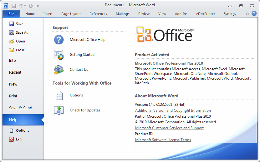

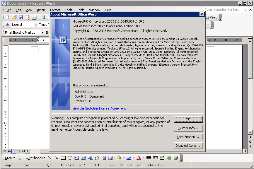

The exact version of Microsoft Word 2003 can be determined by selecting the 'Help' menu, and selecting the 'About Microsoft Office Word' entry.
The exact version of Microsoft Word 2007 and Microsoft 2010 can be determined by selecting the 'File' tab, and selecting the 'Help' entry.
See the screenshot below:
