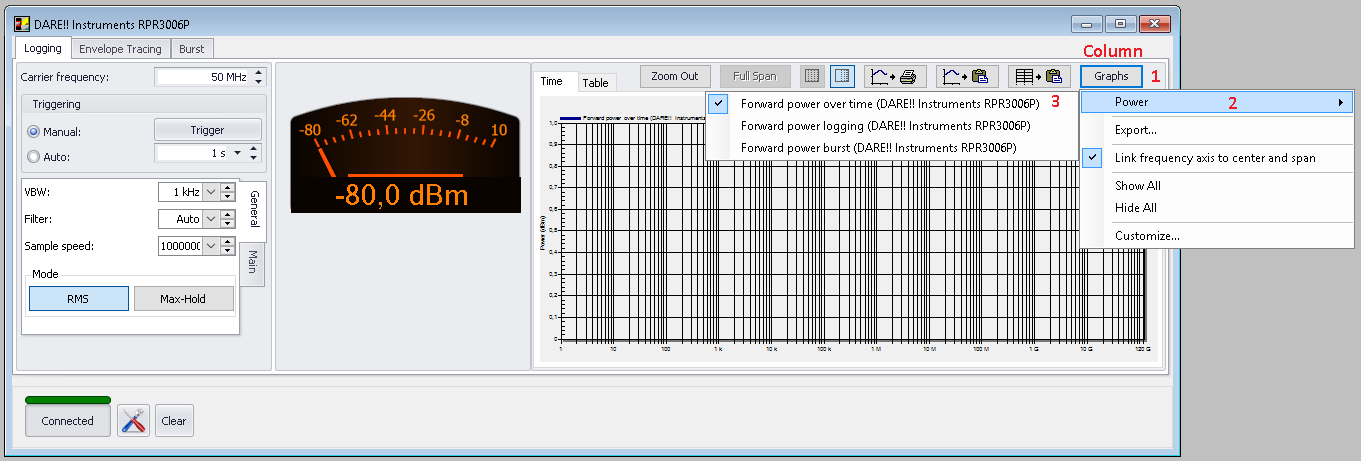

The power meter being used is frequency dependent device. The powermeter therefor measures different powers for each frequency.
If no correction factor is applied at the device configuration window, then it seems that the powermeter raw values are measuring a difference of 1dBm between those frequencies.
As of the screenshots, I can see that the Table on the right does not show correct values.
This is an bug (Fixed/released in the 2017.1+ version) in RadiMation that shows incorrect values in the table if no graphs are selected to be visible.
"#7773 Incorrect table information for frmVIPowerMeter at the ctlControlGraph table"
To show correct values in 2016.2.10, please make the power over time graph visible in the Graph/Column menu:
