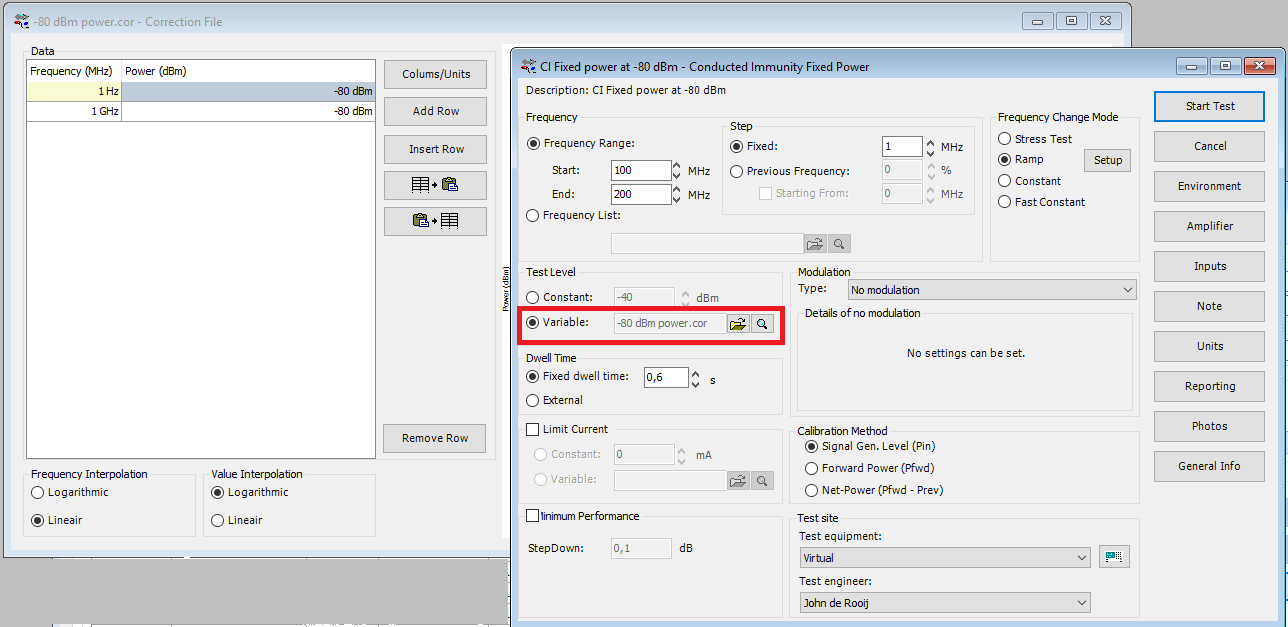

However a workaround is available.
We suggest to create a correction file that contains the desired signal power value (for example -80 dBm), and select that correction file as a 'Variable' testlevel file in the Conducted Immunity Fixed power test.
See the screenshot below:
Variable testlevel file of -80 dBm in a CI Fixed power test
With this configuration the Conducted Immunity Fixed power test will be performed with a signal generator carrier level of -80 dBm.

Thanks, its working with this workaround.
