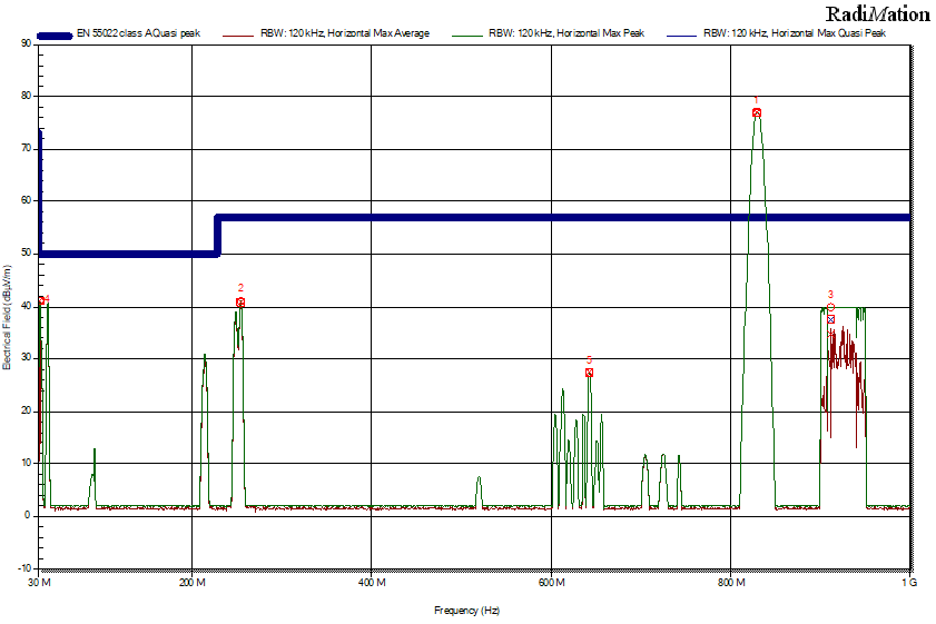

To include the complete emission graph, you can use the following code:
||MAX HOLD PEAKS GRAPH||
This will result:

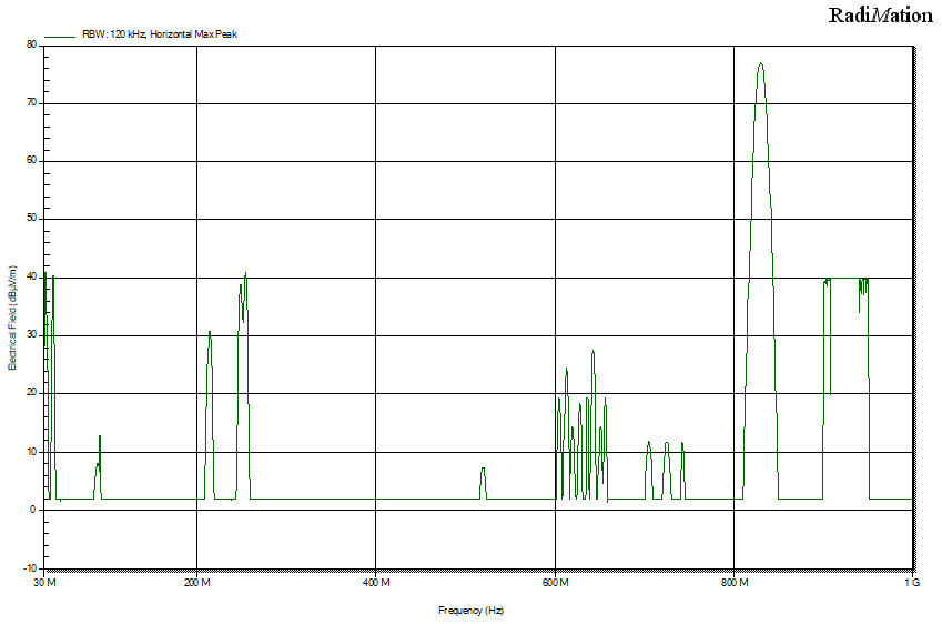

If you however would like to use separate graphs for the different graph lines, just use the real graph line names as the code.
||RBW: 120 kHz, Horizontal Max Peak||
Will only show the peak prescan graph only:

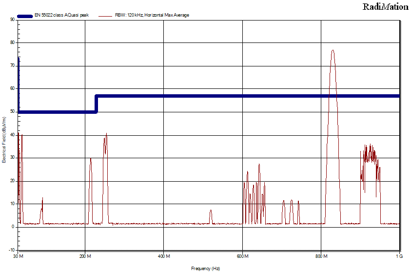

Multiple graph lines can also be combined by ;-seperating them:
||RBW: 120 kHz, Horizontal Max Average; EN 55022 class A Quasi peak||
will show the average trace prescan graph with the limitline:

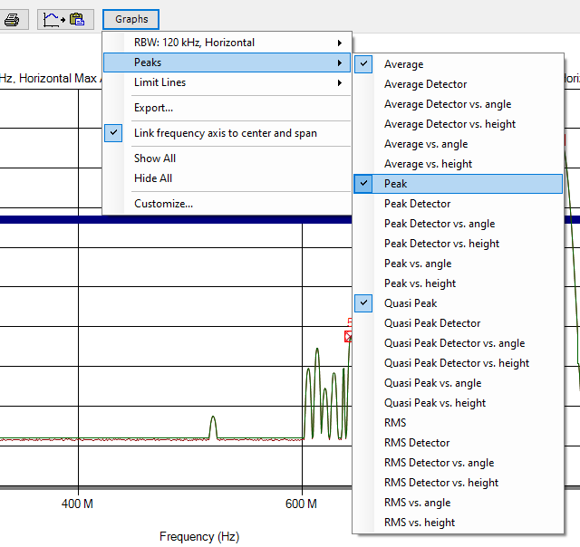

Thank you for your answer. I could separate the graphs with the described procedure. But now the markers for quasi peak and average final measurements are missing in the plots. I have no idea how to name these markers in the template.
Re: How to include only the average plot in a report?
Posted: 25 May 2020, 14:14
The markers for the final measurement of the average and the quasi peak detectors, are just normal graphs. However those graphs are not included in the graphline index above the graph.
Within RadiMation the markers can be shown (or hidden) by clicking on the 'Graphs' button, and then select the 'Peaks' submenu to select the desired peaks.
Showing/Hiding final measurement markers from the Graphs menu
The names in that last shown popup menu are also the graph names. Just to show the quasi peak final measurement markers, just include 'Quasi Peak' as graph name.

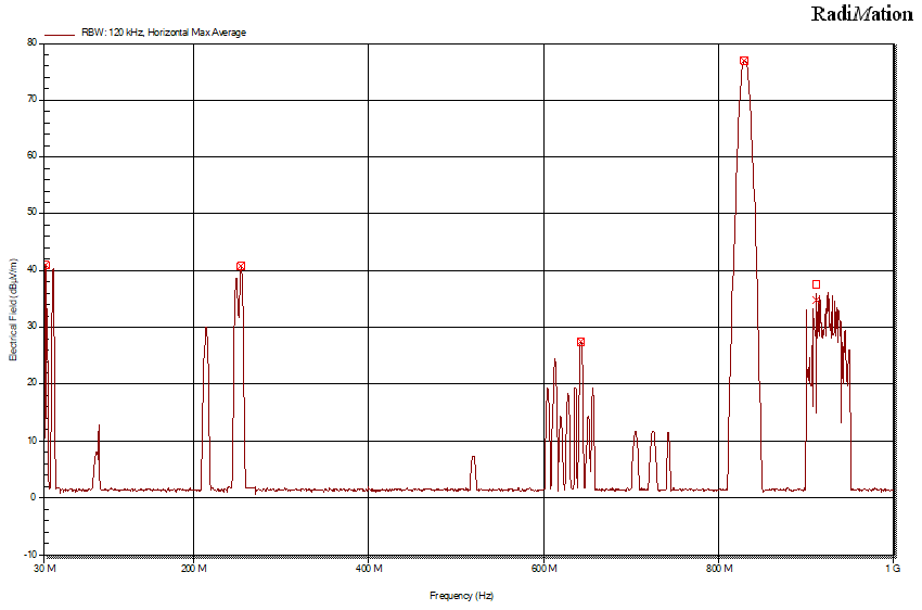

||RBW: 120 kHz, Horizontal Max Average; Average; Quasi peak||
Will thus show the Average graph line, with the Average and Quasi peak markers:

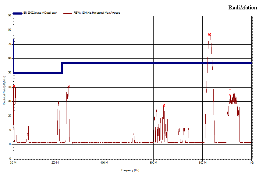

||RBW: 120 kHz, Horizontal Max Average; Average; Quasi peak; EN 55022 class A Quasi peak ||
Will then also include the limit line:
