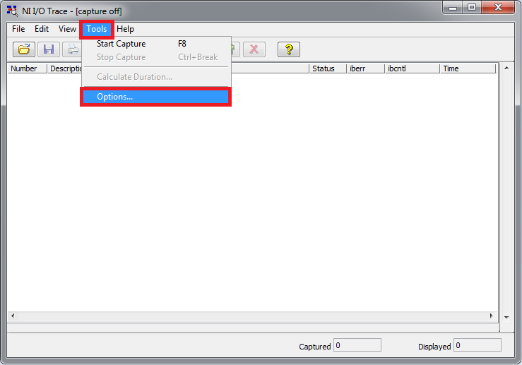

After opening start with the configuration the appropriate settings, with Tools -> Options...
2. Open tools - Options NI-trace.png (27.15 KiB) Viewed 24439 times

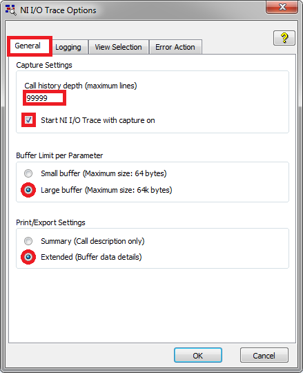

Change the settings from the General Tab to the following settings (required):
3.1 Options - General tab NI-trace.png (23.23 KiB) Viewed 24439 times
This tab contains mandatory settings for your capture files. It is most important to change all these settings very carefully , otherwise your captures could be completely useless.

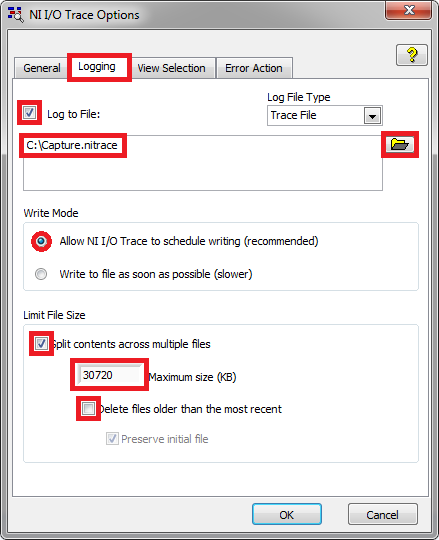

Change the settings from the Logging tab to specify a location where the captures should be saved and if the should be split (optional):
3.2 Options - Logging tab NI-trace.png (22.87 KiB) Viewed 24439 times
If you use the 'Limit File Size', make sure that you have unchecked the 'Delete files older than the most recent' option.

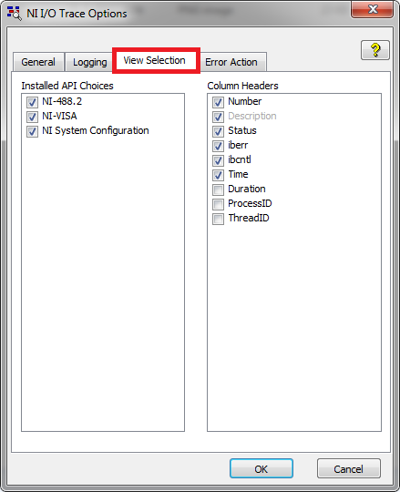

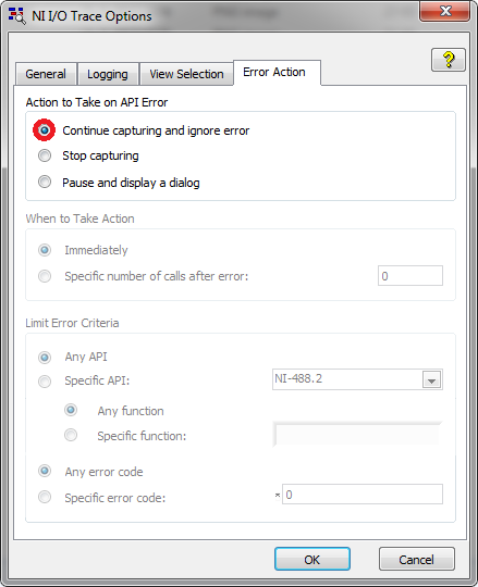

After that, please check the other Options tabs (View and Error), to make sure you are using the correct settings;
3.3 Options - View Selection tab NI-trace.png (21.06 KiB) Viewed 24439 times
3.4 Options - Error Action tab NI-trace.png (29.12 KiB) Viewed 24439 times

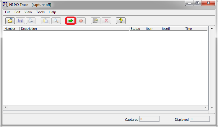

Now you have configured the NI I/O trace, the capture will automatically start when starting program. (This setting has effect after restarting the program once.)
To check if the capturing is indeed turned on this can be verified by reading the name from the main window, it should say [capture on]. If it isn't automatically started (or you prefer to start it manually) use the button with the green arrow to start capturing;
4. Start Capturing NI-trace.png (20.14 KiB) Viewed 24439 times

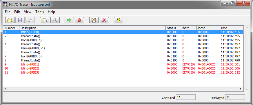

During capturing it is needed to perform tests or have communication with device(s) to be able to capture any communication. So, once you have started a new and empty NI I/O trace capture start the application you want to monitor and you will see that the first lines are already captured by I/O trace. It should look something like this screenshot. Now, perform the necessary test(s) or check(s) that are generating problems or needed for support. If you have more then one issue, it's often desirable to start with a new capture for each issue.
4.2 During capturing NI-trace.png (31.96 KiB) Viewed 24410 times

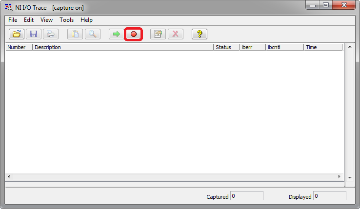

Only after the capturing is stopped it is possible to save your capture. To stop capturing use the button with the red circle;
5. Stop Capturing NI-trace.png (20.43 KiB) Viewed 24439 times
Then the main screen should say [capture off].
