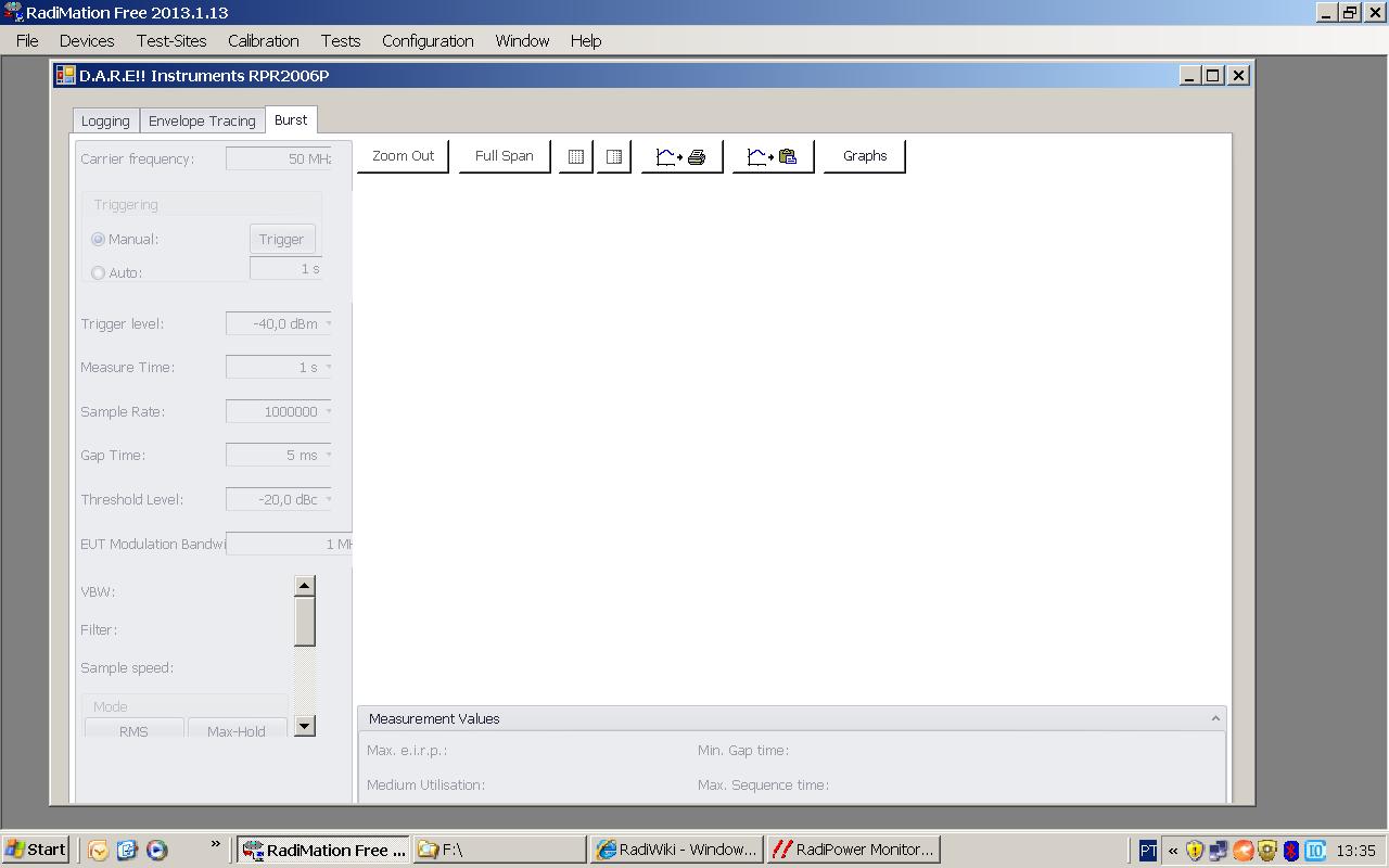

Try to use Radimation but although all checks are ok (system detects the sensor), can not start measurement (see attachment all blank.jpg)

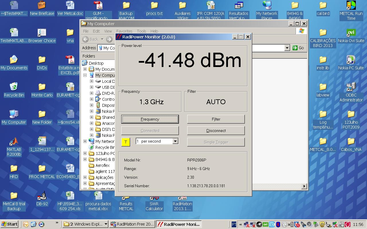

See also attachment Radipower screen.jpg (is this the correct version to use?)

For the 300 328 standard it is absolutely necessary to use RadiMation, so the RadiPower Monitor program cannot be used. Additionally we have replaced this program by RadiMation Free, so it is now not officially supported anymore.
jobelo wrote:Try to use Radimation but although all checks are ok (system detects the sensor), can not start measurement (see attachment all blank.jpg)
From the screenshot it can be seen that your OS display settings are not default, but set to the medium (125%) or larger (150%) setting. It looks like this is causing the test window to be not completely visible, approximately 10% seems to be cut off. The screen should have a 'Connect' and a 'Settings' button on the bottom in the leftmost corner. We understand that this seems to be a compatibility issue with Windows which should be fixed.
For now I suggest to change the OS display settings back to the default and start RadiMation Free again. It should now show the 'Connect' button:

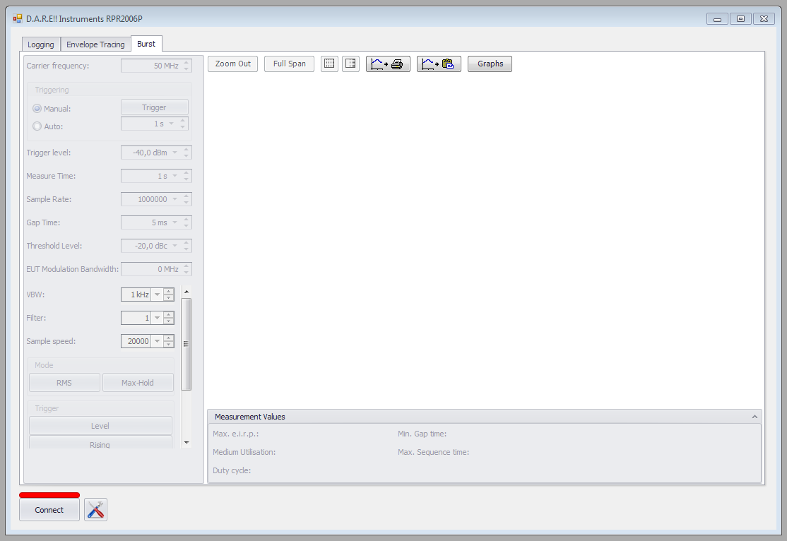

RPR RadiMation Free screen.PNG (38.47 KiB) Viewed 10862 times
After you connect with the RPR you should be able to perform the test and the blank screen will go away.
